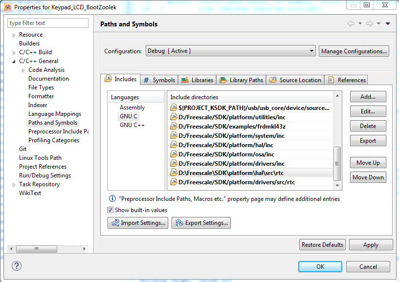

Hello, I am willing to implement RTC based on the example app from Kinetis SDK 1.2.0 for KL43.
I added following folders as the header files source, they are the same as the ones for the RTC example (and a couple more):

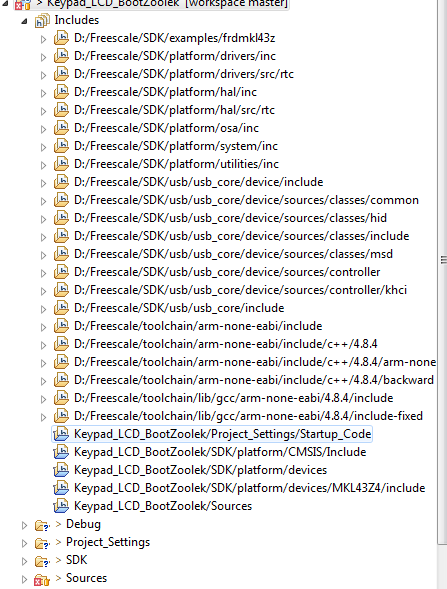

Header files are successfully recognized, however, I am missing the source files connected to them. For example fsl_rtc_driver.h has the bool RTC_DRV_IsAlarmPending(uint32_t instance); function prototype. It is obvious that its body is present in fsl_rtc_driver.c which is in the folder I also included into project settings. Unfortunately it does not see any of the .c files, even though they are correctly seen in the project tree:

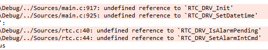

Compiler gives following errors:
Since the path with required .c source files is correctly added - I don't know what am I missing.
There must be some non-manual way to fix this problem. How to do it?

Each of the example projects have the KSDK platform library linked. You have built the library but most probably you are missing the step of linking the generated library object file to your project. You can do this from Project -> Properties -> C/C++ Build -> Settings -> Cross ARM C Linker -> Other objects.
