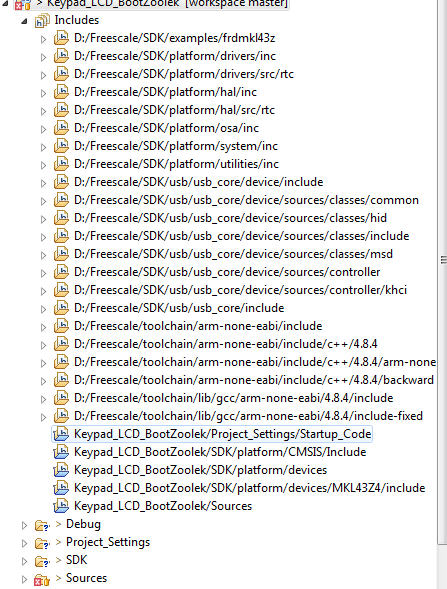

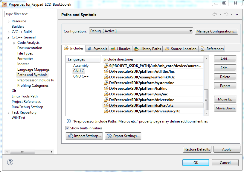

I added following folders as the header files source, they are the same as the ones for the RTC example (and a couple more):

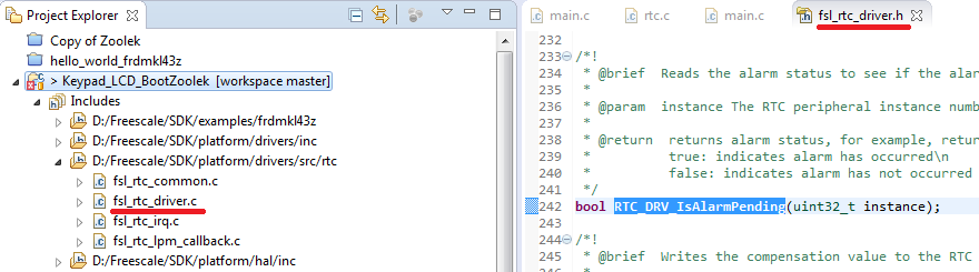

Header files are successfully recognized, however, I am missing the source files connected to them. For example fsl_rtc_driver.h has the bool RTC_DRV_IsAlarmPending(uint32_t instance); function prototype. It is obvious that its body is present in fsl_rtc_driver.c which is in the folder I also included into project settings. Unfortunately it does not see any of the .c files, even though they are correctly seen in the project tree:

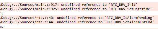

Compiler gives following errors:
Since the path with required .c source files is correctly added - I don't know what am I missing.
There must be some non-manual way to fix this problem. How to do it?
