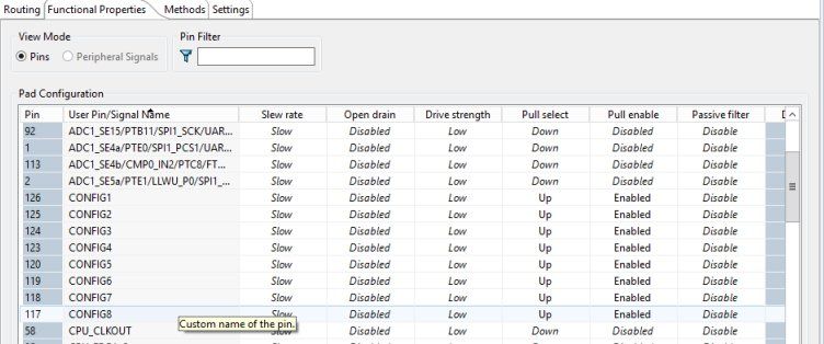

I'm scratching my head trying to read an 8 pin dip switch connected to port pins PTC12 through to PTC19. I can only successfully read the status correctly of the one connected to PTC19. All the others only show as high if I have the pull-up enabled, and low if the pull-up is disabled no matter the state of the switch.
I've configured the pins in pin_mux to have the gpio function enabled with pull-up enabled as below

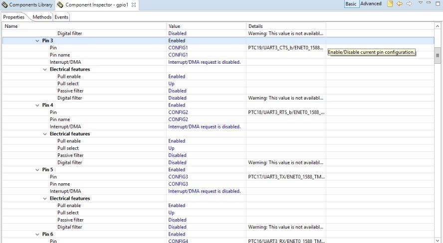

and then setup as input in the gpio component.
And then in my code i'm calling the function GPIO_DRV_ReadPinInput to read the state of each pin and outputting the result to the console.

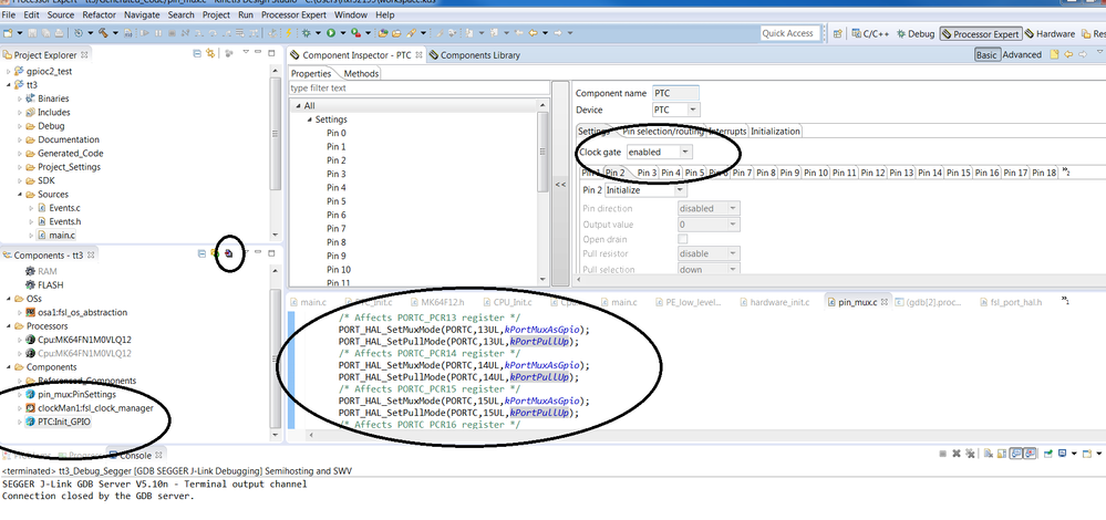

KDS's Processor Expert is a bit confusing I must to say. So please look at this picture:
There are some steps you must to do:
1. Set pin mux, and maybe pullup if it is needed;
2. Open the clock. The corresponding function is CLOCK_SYS_EnablePortClock();
3. Leave the pin in input mode;
4. Each time you modified in Processor Expert, you'd better push the "generate Processor Expert code" button.

Thanks for the pointer, I wasn't using Init_GPIO just fsl_gpio and pin_mux. I've added Init_GPIO and enabled the clock gate as you've shown however it hasn't made a difference. Anything else that could have an effect?
The pin_mux.c file seems to be generated correctly as it has the following.
