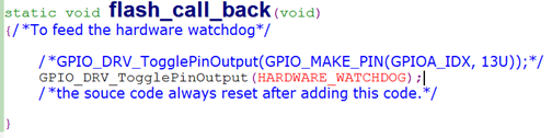

The SDK_1.3 of KL36 is used in my project.
My source code is in the attachment.

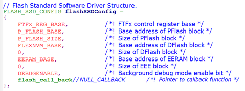

  1. I need to feed the external watch dog when erasing the flash. So I add a “flash_call_back” function to the “flashSSDConfig”.172178_172178.pngpastedImage_1.png

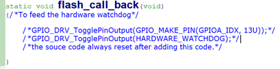

  2. The flash erasing in the function “fapp_params_to_flash();    ” is OK before adding “GPIO_DRV_TogglePinOutput(HARDWARE_WATCHDOG);” to the “flash_call_back”.172179_172179.pngpastedImage_2.png
  3. The flash erasing is failed after adding “GPIO_DRV_TogglePinOutput(HARDWARE_WATCHDOG);” to the “flash_call_back”. The CPU always resets and it is caused by the “core lockup”(The bit “LOCKUP” of RCM_SRS1 is set as 1).172182_172182.pngpastedImage_5.png
Can you tell me what is the reason?

Hi, Robin,
Can you copy the body of void flash_call_back(void); from flash to internal RAM and execute the api function in internal RAM? I suppose that when you execute the flash_call_back() function, the erasing/programming flash process has not been complete yet, if you execute the flash_call_back(0 function which is saved in the same block as you are ersaing/programming the flash, there is issue.
Pls have a try.
XiangJun Rong
