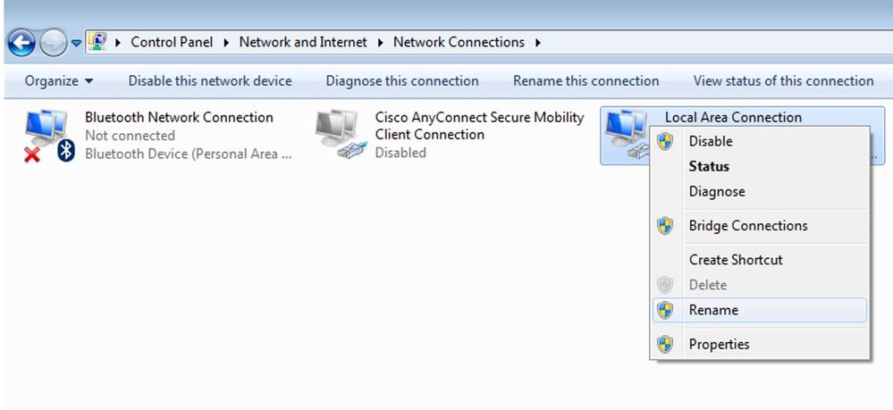

hello,
I run the  tcpip examples of ksdk on the frdmk64f in kds,but it's can't work ,both of the "eth_to_serial_frdmk64f" and "httpsrv_frdmk64f"
when I run the examples,the the uart is ok and output the "
Application listening on following ip addresses:
  IPv4 Address: 192.168.1.202, port:23
but the network interface seems can't connent,
should I close some correct jumper settings?
ButI don't found any jumper setting in "MQX Getting started" document

isaacavila

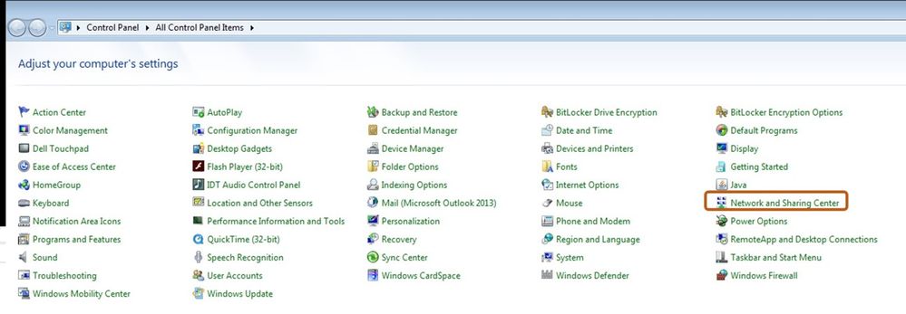

Hello Wang,
There is readme file located in <KSDK_PATH>\middleware\tcpip\rtcs\examples\httpsrv and <KSDK_PATH>\middleware\tcpip\rtcs\examples\eth_to_serial that lists the steps needed to run the example.
In this file, step 3 says:
3) Connect the evaluation board and your PC to same Ethernet network.
This instruction requires to do next steps:
  • Go to Control Pnale and Select Network and Sharing Center

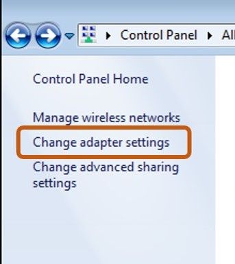

  • Selec the option Change adapter settings on the lef list options
  • Modify Local Area connection by right-clicking and select properties.
  • At this point, your Ethernet cable needs to be removed from your internet network and connect it to your board.
  • In next window, select Internet Protocol Version 4 (TCP/IPv4) and de-select obtain an IP address automatically and instead use a specific IP address: For example 192.168.1.200 (it should be different to your board's IP address) and save these settings.
  • Set IP Address.jpgAfter this, you should de able to connect to your board. Could you please try these steps as well as others shown in readme file?
