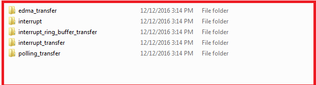

Regarding your question, I think there are several  examples for the uart:
1)Polling_transfer: the example uses polling mode to read/write the uart data register, in other words, it polls the uart status register to check if the transmit register is empty or the receiver register is full.
2)interrupt example: it uses interrupt mechanism to write/read uart data register, in detail, in the ISR of uart transmitter, it write data register.
2)interrupt_transfer example: Firstly, it uses interrupt mechanism to write/read uart data registers, but it defines a structure
    uart_transfer_t sendXfer;
    uart_transfer_t receiveXfer;
when the block of data has been transfered completely, a callback function is called.
3)the interrupt_ring_buffer_transfer uses ring buffer, the other is the same as interrupt_transfer example, the edma_interrupt uses edma to transfer data.
4)there is an example located at:C:\DriverE\Freescale\SDK2.0_K22FProcessor\boards\twrk21f120m\rtos_examples\freertos_uart
