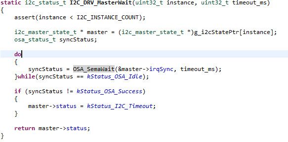

I'm exploring the I2C with RTOS example found at C:\Freescale\KSDK_1.2.0\examples\frdmk22f\demo_apps\i2c_rtos\i2c_rtos_mqx\kds and noted the use of the I2C_DRV_MasterSendDataBlocking() function.
When it's being used in MQX like this am I understanding it right that only the task calling this function is blocked and the remaining MQX tasks will continue to run?

Hi David,
Your understanding is right. In some part in the I2C_DRV_MasterSendDataBlocking() a OSA_SemaWait functions is called. You can check the next i2c wait functions:
therefore waiting for a semaphore to be posted by another event or task will cause a wait in the current task allowing other tasks be handled by the Operating System meanwhile.
Hope this information can help you

Hi Adrian,
That's what I was hoping!
Thanks for the quick response.
