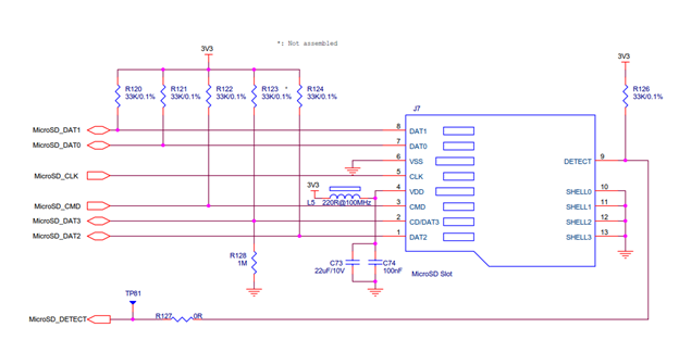

Because the micro SD card is used in my product. The hardware is a little different from the twrk64120m.

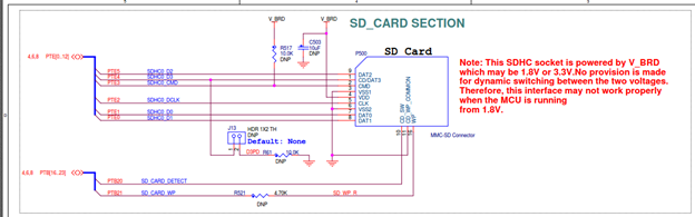

The hardware in my product.
The hardware in the twrk64120m.

About your hardware and the one in TWR-K64, example does enable internal pull-up resistors for every pin:
void configure_sdhc_pins(uint32_t instance)
  /* Affects PORTE_PCR3 register */
  PORT_HAL_SetMuxMode(PORTE,3u,kPortMuxAlt4);
  PORT_HAL_SetPullMode(PORTE,3u,kPortPullUp);
  PORT_HAL_SetPullCmd(PORTE,3u,true);
  PORT_HAL_SetDriveStrengthMode(PORTE,3u,kPortHighDriveStrength);
  /* Affects PORTE_PCR1 register */
  PORT_HAL_SetMuxMode(PORTE,1u,kPortMuxAlt4);
  PORT_HAL_SetPullMode(PORTE,1u,kPortPullUp);
  PORT_HAL_SetPullCmd(PORTE,1u,true);
  PORT_HAL_SetDriveStrengthMode(PORTE,1u,kPortHighDriveStrength);
  /* Affects PORTE_PCR0 register */
  PORT_HAL_SetMuxMode(PORTE,0u,kPortMuxAlt4);
  PORT_HAL_SetPullMode(PORTE,0u,kPortPullUp);
  PORT_HAL_SetPullCmd(PORTE,0u,true);
  PORT_HAL_SetDriveStrengthMode(PORTE,0u,kPortHighDriveStrength);
  /* Affects PORTE_PCR5 register */
  PORT_HAL_SetMuxMode(PORTE,5u,kPortMuxAlt4);
  PORT_HAL_SetPullMode(PORTE,5u,kPortPullUp);
  PORT_HAL_SetPullCmd(PORTE,5u,true);
  PORT_HAL_SetDriveStrengthMode(PORTE,5u,kPortHighDriveStrength);
  /* Affects PORTE_PCR4 register */
  PORT_HAL_SetMuxMode(PORTE,4u,kPortMuxAlt4);
  PORT_HAL_SetPullMode(PORTE,4u,kPortPullUp);
  PORT_HAL_SetPullCmd(PORTE,4u,true);
  PORT_HAL_SetDriveStrengthMode(PORTE,4u,kPortHighDriveStrength);
  /* Affects PORTE_PCR2 register */
  PORT_HAL_SetMuxMode(PORTE,2u,kPortMuxAlt4);
  PORT_HAL_SetPullMode(PORTE,2u,kPortPullUp);
  PORT_HAL_SetPullCmd(PORTE,2u,true);
  PORT_HAL_SetDriveStrengthMode(PORTE,2u,kPortHighDriveStrength);
So you have two pull-up resistors (one internal and other external), so please, disable this internal pull-ups to discard this can be causing the failure.
