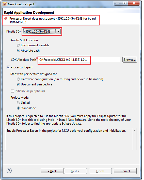

I am trying to work with FRDM-KL43Z freedom board using KDS-3.0 + KSDK1.2.0 i am not able to access SLCD component for this board.
I have installed the patch for this board “Kinetis SDK1.0.0 Standalone for the FRDM-KL43Z & TWR-KL43Z48M - Windows 32-bit Installer”  and update software from
KDS window >help> install new software
While creating the project for KL43Z in kds it is not accepting KSDK installed path as shown below
It says “processor expert does not support KSDK1.0.0-GA-KL43 for the board FRDM-KL43Z”
Is there any other packages need to be installed:

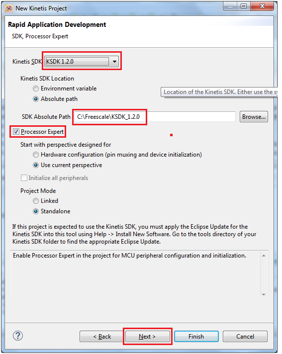

And also i tried by giving the path KSDK 1.2 it is accepting without errors as shown below:
Here when i am selecting the component for SLCD i.e component fsl_slcd does not appear in the list of “applicable to project”
Is there any other supporting software need to be installed or am i making some mistake while creating project?

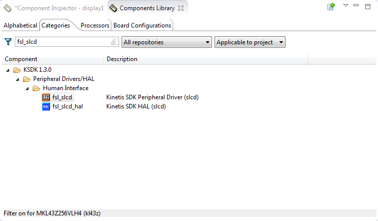

Hello Bheema Rao,
please, use the newest KSDK, actually KSDK 1.2, there is support for KL-43Z implemented.
And unfortunately the component fsl_sldc is not supported by PEx KSDK 1.2,
it will be supported by KSDK 1.3.
I apologize for inconvenience this may cased.

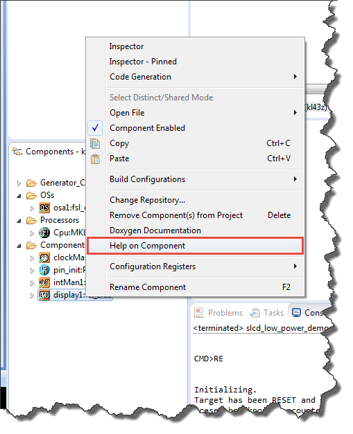

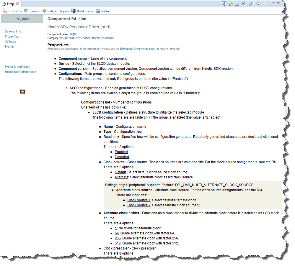

ivadorazinova
Hi Bheema,
no, these examples are without PE.
Anyway, maybe can help you help for slcd component located under Help on Component
Hope this helps.
