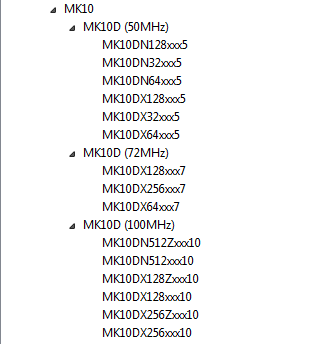

I have problem in identifying the support of the SDK for the following processors:
MK10DN32VMP5
MK10DX32VMP5
MK10DN64VMP5
MK10DX64VMP5
MK10DN128VMP5
MK10DX128VMP5
Are any of supported???

Hello Pietro,
thank you for this very good question.
I checked your mentioned MCU and SDK support MCU and there is a main difference - there are different processors,
so there is no direct SDK support, but - I see support of KDS, so you can modify the code for KSDK.
I attach you the guide.
Does it help you?
Iva

Dear Pietro,
I am afraid that there is only support for the Kinetis K10 that runs at 100 MHz (MK10DNxxxxxx10 and MK10DXxxxxxx10).
