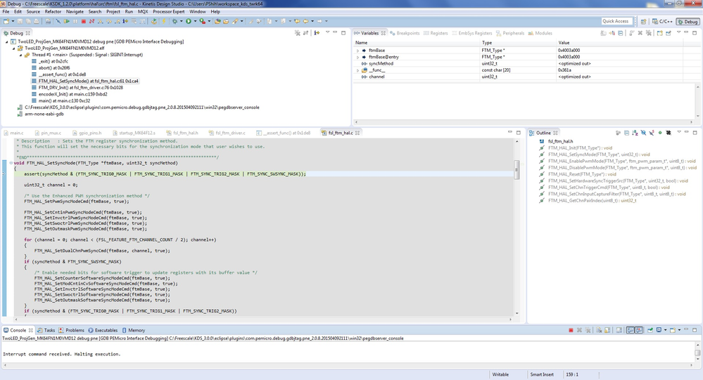

I am working on quadrature decoder on FTM with TWR-K64F120M by using KDS3.0 and KSDK1.2. I have encoder connected to PTB0 and PTB1 and declare as
FTM1_QD_PHA and FTM1_QD_PHB, and able to see the signal on the scope. However, I am not able to initialize the FTM1 properly. The initialization always get stuck at FTM_HAL_SetSyncMode() in FTM_DRV_Init(). Please let me know if you have any idea or recommendation for me to clear the problem. Thanks!

xiangjun_rong
Hi, Peter,
I hope you can attach your project to the community so that we can test your project on my K64 board. If you use FTM to count the phaseA and phaseB signals from encoder, I do not think it is necessary to call the  FTM_HAL_SetSyncMode() function.

petershih
Hi XiangJun:
As you mentioned, I don't need to call FTM_HAL_SetSyncMode() function. However, it is called from FTM_DRV_Init(). Since I am using KSDK, I have no choice to avoid it except modifing source code. Actually, I set .syncMethod to "kFtmUseSoftwareTrig" instead of "0", and It works OK. I think this is what I am going to use for now. Thanks your help!
