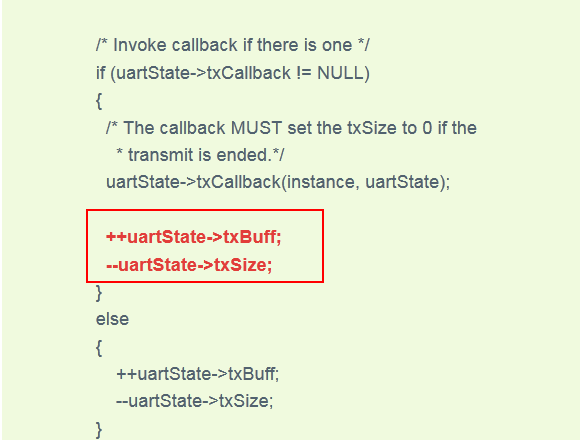

I got a problem and I came here to ask if some of you might help me… I am using the board FRDM-K64F with the following software solutions:
KDS 3.2;
Processor Expert;
KSDK 1.3;
MQX provided by KSDK;
I am trying to develop an application to test one uart of the board, in the pins PTC14 and PTC15. The physical connections appeared to be fine, but there is something wrong with my software or my processor expert configuration, because when I run the code, nothing happens. The code follows annexed.

Hi Clecio:
Have you solved this issue? I tried your project after deleting the "\r\n", and found it still does not work. There is a bug on the function of "UART_DRV_IRQHandler", in file fsl_uart_driver.c.  the code will never move the position of TXbuffer and transfer byte numbers, so it lead to never to call UART_DRV_CompleteSendData.
please add the two read lines to the receive interrupt and send interrupt,
please check the below picture.
Your also can refer to the below thread.
The usage of UART callback function install

Hi Daniel.
Thank you for the help. As you said when I deleted the “\r\n” the project kept not working. Making the alteration from the picture you send, the project started to work, and I am very thankful for that. However, making a little research I found some topic in this forum where they found a similar bug, but in the rx buffer. Do you know if this information proceed?
