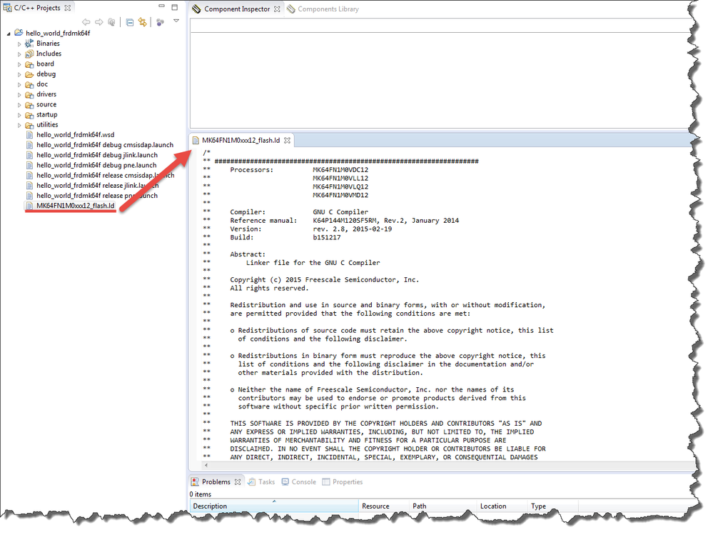

I would like to ask where is the linker file flash.ld? in my case when i create a variable and try to run the project i can see that it is not on RAM range and the variable is not usable. am i doing anything wrong?

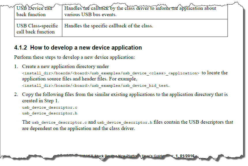

Iva, I don't see any possibility for adding USB framework to the generated project. Am I missing something or is this planned for later?
Hi Edriano,
In case you clone the project and import it to KDS (from user_apps folder located c:\Freescale\KSDK 2.0\SDK_2.0_FRDM-K64F\boards\frdmk64f\user_apps), you will see i.g. MK64FN1M0xxx12_flash.ld file under your project shown below:
Kind Regards,
Iva
Hi Alex,
unfortunately, this option is not possible by Project Generator Tool.
But I will pass this feedback to Development Team, thank you.
Anyway, you can take a look at examples for USB under <ksdk2.0_path>\boards\frdmk64f\usb_examples\
and try it according to USB Stack User´s Guide.pdf where is described procedure how to develop new USB application.
Please see chapter 4.1.2 How to develop a new device application
I hope this helps you.
Iva

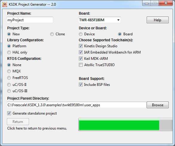

I seem to have found a bug. With this configuration, the project keeps generating forever, continually filling and clearing the progress bar. It creates the myProject directory but no files have been placed there.
Also, if I choose a generated 2.0 SDK, only the KDS toolchain shows up as an option (didn't see this obvious known issue in the Release Notes).
Lack of USB code generation and no pin mapping utility is a problem as well. Finally, a Users Guide is badly needed, even with the lack of features. This software doesn't seem to have any real value at this point. I think this version is too premature to have been released. When is the next planned update?
Hi Paul,
If my understanding is correct, I can´t confirm this bug on my side.
I tested with your configuration and it works without problems. Generating process successful finished and in folder are placed all needed files.
Please see the attached video.
To your second point, it depends, what tool chain did you select when you download the KSDK 2.0. So if you selected KDS, you will see KDS.
With USB Stack - it is a good point, there is only option for cloning demo_apps examples and is not possible to add USB Stack to your code using this tool.
I will ask about this option for future release and let you know.
Thank you for your valuable contribution.
Kind Regards,
Iva

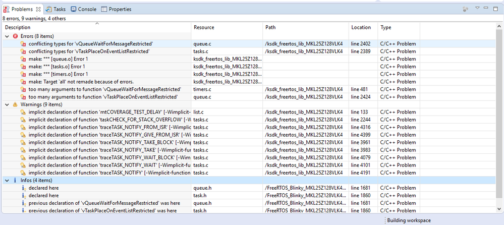

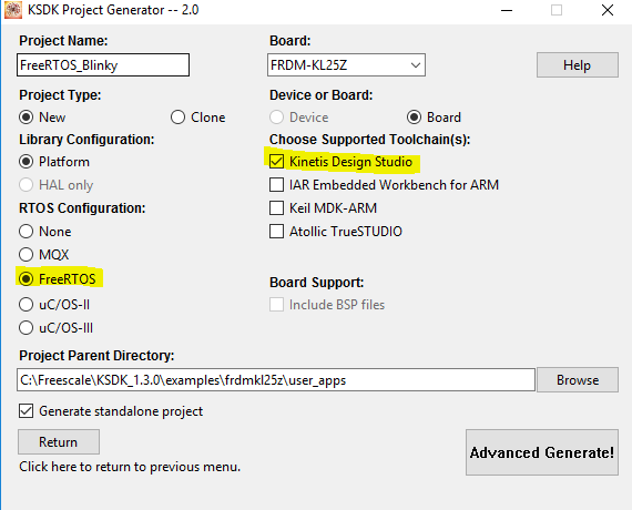

Greetings Iva,
thanks for this link! Using the Project Generator V2, I created a simple blinky project using FreeRTOS on KDS. So I select these under "Advanced Generate". Then I simply import the project(right mouse click -> import -> Project of Projects) and corresponding RTOS_lib in my project workspace. But I get error when I build the KDSK_FreeRTOS_lib_MKKindly refer the two screenshots.
What do you suggest?
Nirav
