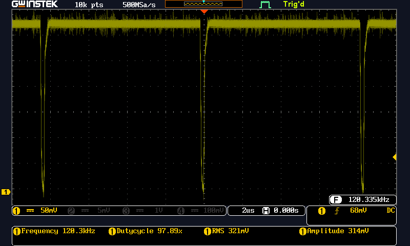

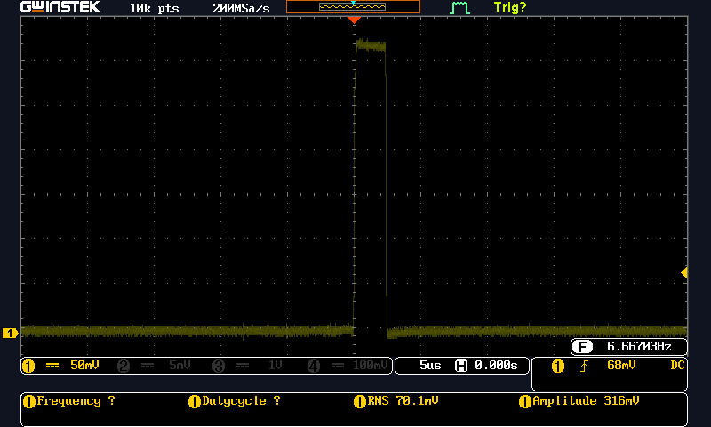

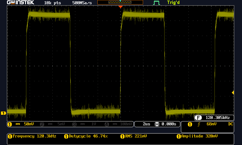

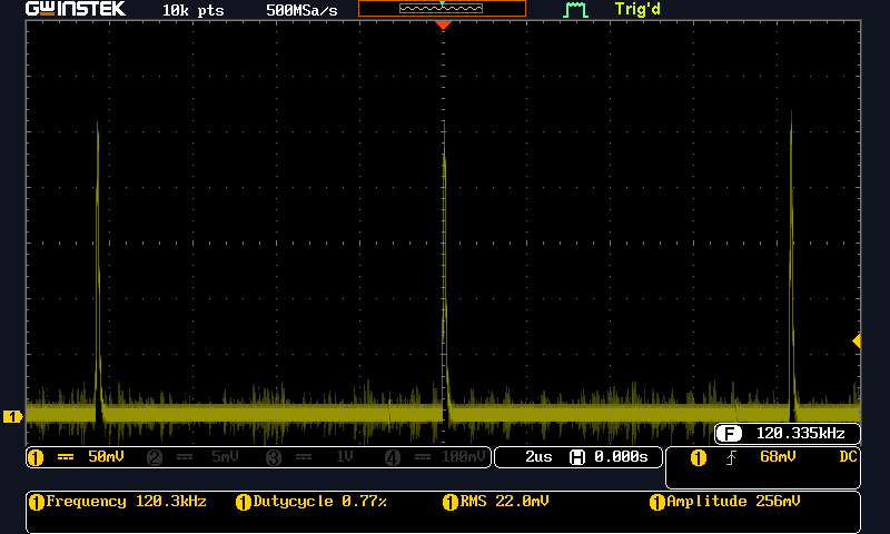

lucianfiran
Contributor V
When I use the fsl_tmp_driver to fast update pwm for 3 led channels I got some unpleasant flickering.
I change only duty cycle.
The workaround found and working, is to init and start PWM in init_function:
    TPM_DRV_Init(BOARD_TPM_INSTANCE_0, &driverInfo_0);
    TPM_DRV_SetClock(BOARD_TPM_INSTANCE_0, kTpmClockSourceModuleClk, kTpmDividedBy2);
    and start pwm once
    TPM_DRV_PwmStart(BOARD_TPM_INSTANCE_0, &param0,  BOARD_TPM_CHANNEL_0_0);
    TPM_DRV_PwmStart(BOARD_TPM_INSTANCE_0, &param1,  BOARD_TPM_CHANNEL_0_1);
    TPM_DRV_PwmStart(BOARD_TPM_INSTANCE_0, &param2,  BOARD_TPM_CHANNEL_0_2);
(get in debug mode get the magic number uMod inside TPM_DRV_PwmStart for my particular setting)
    then update PWM like this:
void BOARD_TPM_out(uint8_t dutyCycle0, uint8_t dutyCycle1, uint8_t dutyCycle2)
    uint16_t uCnv0, uCnv1, uCnv2;
    uint16_t uMod = 132; // get from debug TPM_DRV_PwmStart function
    TPM_Type *tpmBase = g_tpmBase[BOARD_TPM_INSTANCE_0];
    uCnv0 = uMod * dutyCycle0 / 100;
    /* For 100% duty cycle */
    if(uCnv0 >= uMod) {  uCnv0 = uMod + 1;  }
    uCnv1 = uMod * dutyCycle1 / 100;
    if(uCnv1 >= uMod) {  uCnv1 = uMod + 1;  }
    uCnv2 = uMod * dutyCycle2 / 100;
    if(uCnv2 >= uMod) {  uCnv2 = uMod + 1;  }
    TPM_HAL_SetChnCountVal(tpmBase, BOARD_TPM_CHANNEL_0_0, uCnv0);
    TPM_HAL_SetChnCountVal(tpmBase, BOARD_TPM_CHANNEL_0_1, uCnv1);
    TPM_HAL_SetChnCountVal(tpmBase, BOARD_TPM_CHANNEL_0_2, uCnv2);

lucianfiran
Contributor V
My short pwm function looks good:
but the function TPM_DRV_PwmStart pwm generate glitches if changing the same duty cycle near 0%
So another possible workaround is to see if newDutyCycle != oldDutyCicle - only then use the function.
