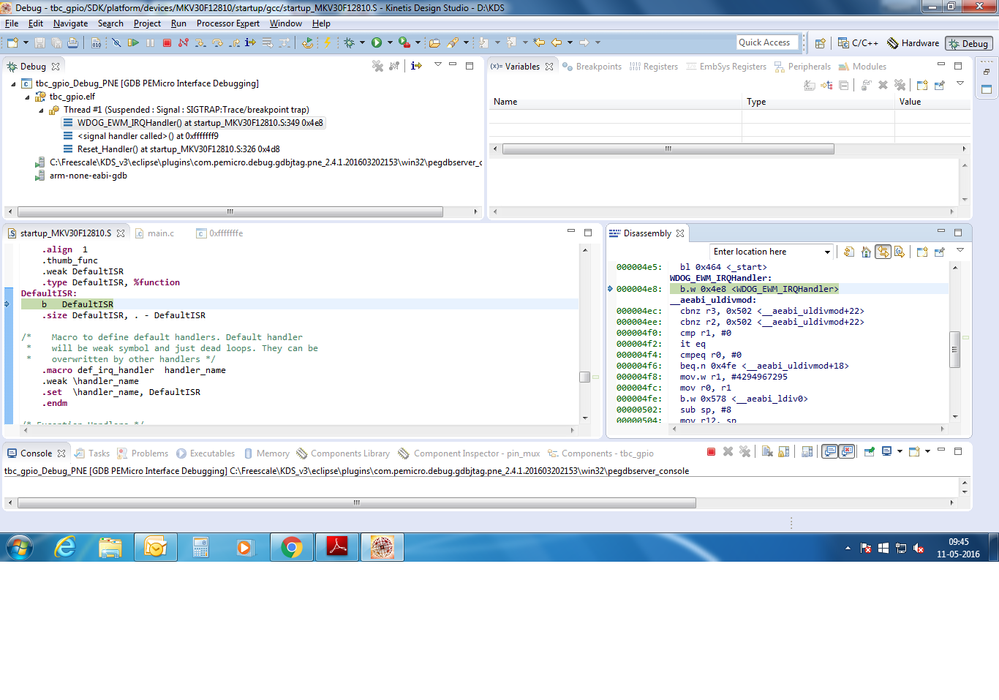

vaibhavsomani
Thanks DavidSfor quick reply.
I have TWR-KV31F120M. My code is also working fine on TWR-KV31.
But when I am flashing same code on my board, on power on reset or reset through pin. It is not working.
In debug mode when jtag connector is connected, I tried to do reset via reset pin. My cursor/pointer is showing DefaultISR due to WDOG_EWM_IRQHandler() ??
And this is defined as dead loop in startup_MKV30F12810.S file. So whenever a reset or power on reset happens it is going to  DefaultISR and stuck in dead loop. Here is the screenshot ..
Please suggest how to overcome on this ?
3,906件の閲覧回数
