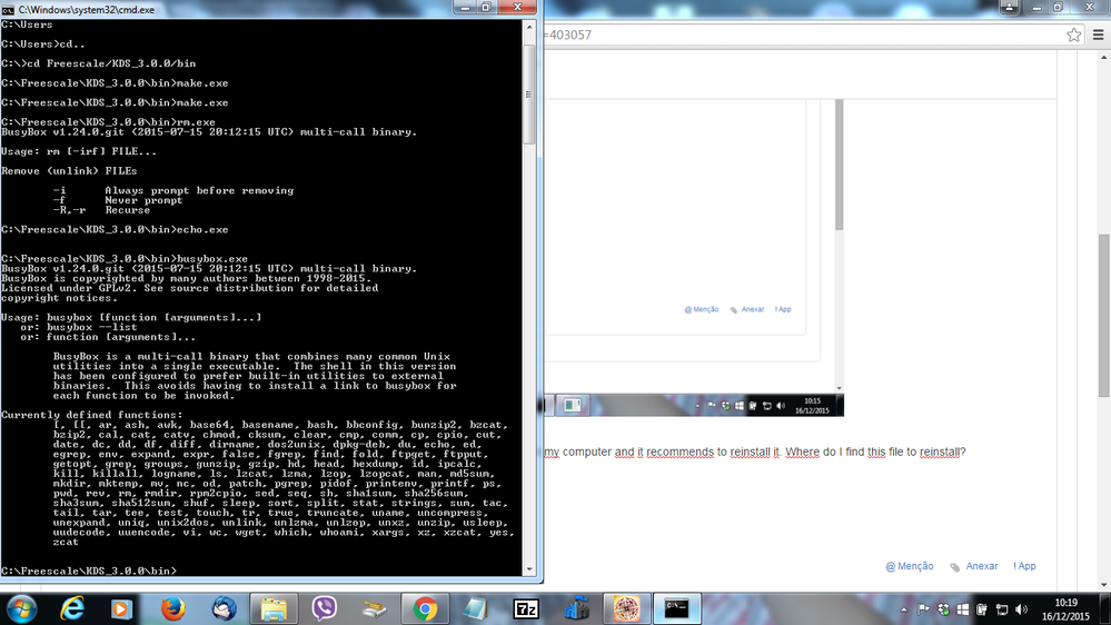

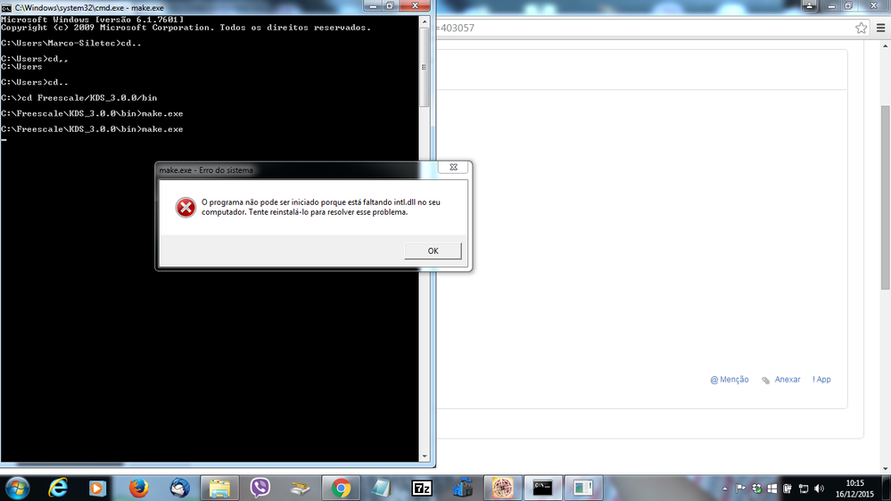

When I executed make.exe in cdm.exe (DOS shell), I got the following:
The dialogue box brings up a message in portuguese that says it is missing a file called intl.dll in my computer and it recommends to reinstall it. Where do I find this file to reinstall?

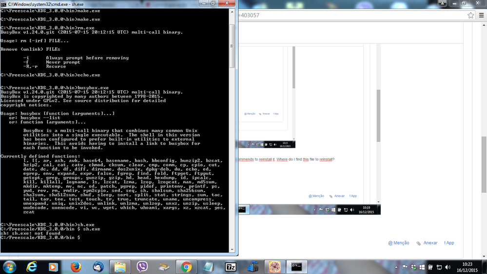

Executing rm.exe, echo.exe and busybox, I have:
"sh.exe" just prints out the money sign "$":
I tried to disable my Anti-Virus, but the error remains.

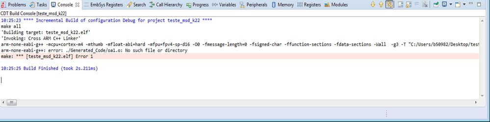

Hello, Isaac
After performing the changes you recommended, the Error 1 disappeared, but it looks like the compiler is not building the project anymore. The *.elf file is not generated and I don't see anything in Console after cleaning and building the project:
