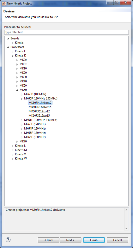

I have the TWR-K60120M and I would like to build the SDK / create new project for this board/MCU with Kinetis Studio... but I don't find the board/MCU reference on the availble list. Are the board / MCU supported by NXP tools ? How can I develop for this device, if it is not supported ?

Hi Tibor.
Unfortunately K60 with 120MHz (TWR-K60F120M) is not supported by KSDK.
For new supported MCU in KSDK please see link https://community.nxp.com/docs/DOC-329783
You can develop in KDS but you should select Processors option and choose specific MCU.
I hope this helps.

Thank you for the info... so for the moment I will use KDS and create SDK 1.0  type project.

yes. You can use KDS but without KSDK support.
At the moment there is no plan to support this 120MHz MCU by KSDK.
You can use other examples for this board - Processor Expert, MQX and other runtime examples.
