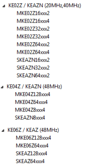

mjbcswitzerland
Specialist V
Hi Helmut
The uTasker project supports KEA family in KDS:
µTasker TRK-KEA128 support
This includes KBOOT compatible loader and simulation of the device and boards.
Note however that the KEA devices are very similar to KE parts so you can in fact use a KE project and make just a few changes to work on the KEAs.
Mark
Kinetis: µTasker Kinetis support
KE: µTasker FRDM-KE02Z support  / µTasker FRDM-KE02Z40M support  / µTasker FRDM-KE06Z support
KEA: µTasker TRK-KEA128 support
