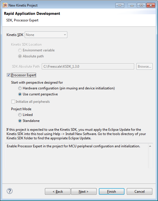

Hi, i am unable to create a project for MK22FN1M0xxx12 with KSDK 1.3.0
am i missing an update? when will it be supported? thanks

Hello ,
Yes , it have not support this chip so far , you can use the Processor Expert development
your project now , this bin also convenient to develop .

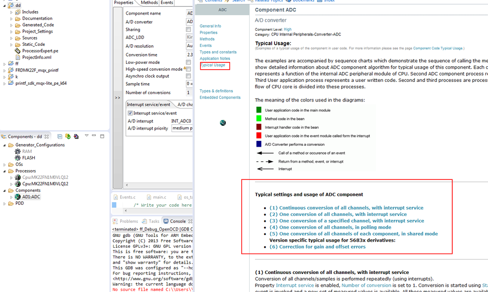

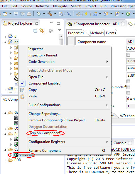

About the PE, there are demo code about the component in the "help on component",
for example the ADC component :
You can refer to the demo code to use the functions .
Hope it helps

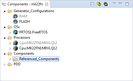

Thanks. I guess that means there is also no freertos and/or mqx port for it?
1,265件の閲覧回数
BlackNight
The MK22FN1M0 is supported with FreeRTOS. It is available from the McuOnEclipse project:
The latest FreeRTOS port for it is available on SourceForge (SourceForge.net ), see Releases on SourceForge  how to install it.
As a bonus, you can use it with the Percepio Trace (FreeRTOS Continuous Trace Streaming) or with the Segger System Viewer (Segger SystemView: Realtime Analysis and Visualization for FreeRTOS​).
