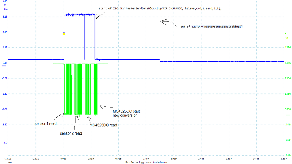

Edit:
in any case it seems that something is not behaving correctly (blue pin toggle, green I2C SCL line)
the end of I2C_DRV_MasterSendDataBlocking() should be shortly after the end of the packet, but it is circa 1 msec after. This value doesn't change even if I modify the timout setting of the function.
Best Regards
Giacomo
