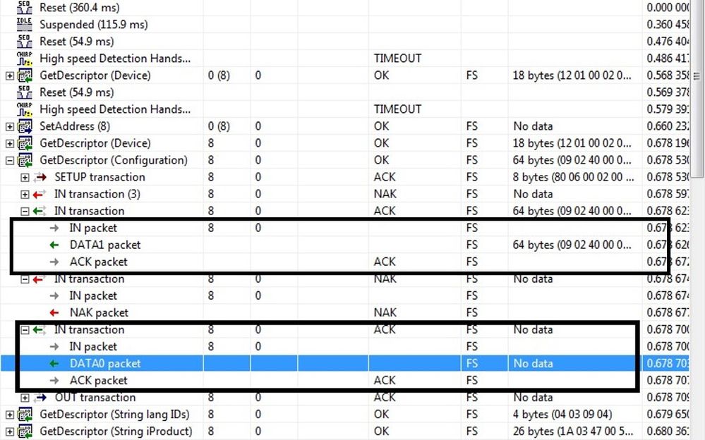

@Mark Butcher found using a hardware USB analyzer:
Your problem is that when the host sends a SetConfiguration (interface 1) your device is responding with a zero data paket (correct) but is it responding with a DATA0 packet, rather than a DATA1 packet and the host rejects this because it is incorrect.
After 5s or so of waiting (the device doesn't send anything else) the host restets the connection and tries again. The same repeats after the reset but sometimes also the SetAddress fails with the device returning malformed frames back - this again causes reset and it goes on forever like this (randomly failing on the SetAddress or the SetInterface).
What I don't know now is how to debug what is going on, where and how it sends it as a DATA0 packet, etc. I am hoping that these three demonstration projects can be used to point me in the right direction.

I just checked the uTasker USB stack's handling of endpoint 0 queue transmissions:
if ((tx_queue->usCompleteMessage % tx_queue->usMax_frame_length) == 0) { // if the transmitted data length was divisible by the frame length
    if (tx_queue->usLimitLength != tx_queue->usCompleteMessage)) {
        FNSEND_ZERO_DATA(ptrUSB_HW, iEndpoint);      // send/queue a zero frame to terminate status stage
That means that it will queue a zero data packet when the complete tx length is divisible by the endpoint length (eg. 64/64 as in the discussed problem case) but not if the host has specified that it wanted this length.
This simple check has proven suitable in many products using USB-MSD and HID, whereby it is to be noted that such a composite's configuration descriptor happens to be always 64 bytes in size so is not an exception of some kind. Therefore I would suggest than anyone who can locate the tx queue in the Freescale stack can add an equivalent check to simply skip adding the zero data packet to the buffer descriptor in the first place to solve the issues.
- usCompleteMessage is the length of the configuration descriptor (64 in this case)
- usMax_frame_length is 64 bytes (endpoint size), but could be 8, which I think also causes the present Freescale stack to fail, but for a slightly different reason since the queued zero data happens to be correct but the following exchange on the bus errors.
- usLimitLength is the size that the host specified to be returned (64 bytes in the issue case)
This seems more practical than waiting for new library releases which may be incompatible or introduce different issues etc.

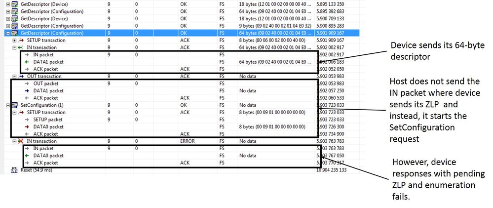

isaacavila
Hello Terry,
USB team analyzed the USB transactions' log and could see that this is a host issue rather than stack. Device descriptor is 64-byte length and our full speed max packet size is 64 bytes too, from the USB spec, an additional zero lenght packet (ZLP) is needed to end the transfer. You can check this log (taken from your example) and in the first GetDescriptor(Configuration) transaction, descriptor is 64-bytes and after this 64 bytes, there is another zero length data (ZLP) from the device. In this case, the host sends the IN packet so transfer is finished correctly.
However, in the error case, after 64 bytes data are sent to the host, the host didn't send out the IN packet and host began the SetConfiguration command instead, while device still has the zero length packet to send (with proper DATA toggle value) so the first response to SetConfiguration command is the zero length packet. You can check this issue in same capture but in the transaction where host fails:
This error is not seen in your msd_hid_inedponit_only because descritpor is 57-byte length instead of 64. I am also attaching the USB capture taken by using Ellisys' analyzer.
I hope this can help you,
Isaac

As mjbcswitzerland​ already said, both conditions are issues (1- If host has specified the exact number of descriptor, like 64 in error case, no additional ZLP is needed and 2- A new setup received before the previous setup finished will end the previous setup process) and therefore, these are issues presented in KSDK 1.3, however, USB team expressed that in next KSDK release (KSDK 2.0, coming soon) the first issue is already fixed so you won't need to add a dummy endpoint in order to modify the descriptor size.
Sorry for all inconvenience it may cause and thanks a lot to mjbcswitzerland​ to add this useful information!

The correct method to handle this is to remove the queued zero data frame when a SETUP is received.
USB specifies that a DATA 1 is returned after a SETUP is received, irrespective of what the host previously did.
Furthermore, the Get Configuration specifically requested 64 byte of data when it performed the Get Configuration descriptor and so already knows that 64 are going to be received, which also overrides any need to request a terminating frame (which is only necessary to distinguish the end of data when its size is not known).
This is therefore definitely not a host error in any way but something that can and does occur in normal operation.
Therefore a workaround by avoiding the length will mostly work - unless the host happens to specifically request 64 bytes [or a multiple of whatever endpoint size is being used - could also be multiple of 8s in some cases] (which is could still do); often the host requests only parts of the data and this is frequently repeated a number of times [with varying lengths] because there may be various SW modues on the host "independently" requesting such information for their own use).
