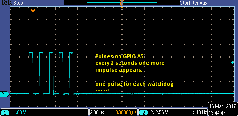

manfredschnell
Hi Xiangjun,
for your hardware test, I wrote an other IRQ-Handler.
It toggles the GPIO A5 as often as the system has been reset by watchdog.
Please replace the IRQ-Handler in my example with this one.
void Watchdog_IRQHandler(void)  {
uint32_t watchdogCount;
  WDOG_ClearStatusFlags(WDOG, kWDOG_TimeoutFlag);
  watchdogCount = WDOG_GetResetCount(WDOG);
  // signal on A5 (TP37)
  while(watchdogCount--)  {
    // Toggle Pins as often as Watchdog happend
    GPIO_SetPinsOutput(GPIOA, BOARD_TP37_PIN_MASK);
    GPIO_ClearPinsOutput(GPIOA, BOARD_TP37_PIN_MASK);
return;
After 10 seconds I got this output:
The System has been reset 5 times. --> every second one more impulse can be see on GPIO A5. --> the system is reset by watchdog!
The maximum of impulses is 10. After that time, the runtime for watchdog IRQ is over and the watchdog resets the system.
Please test this and confirm!
Manfred

manfredschnell
Hi Xiangjun,
in Watchdog_IRQHandler() I show  the value of the Register "WDOG.RSTCNT". The number of impulses represents the register-value. The watchdogCount variable in the picture is 5.
Yes, the number of 10 impulses is determined by the function "interrupt-then-reset" described in "24.6 Generated resets and Interrupts".
After the watchdog IRQ, the system runs for a short time, then the watchdog resets the system.
In my source code, the watchdog is disabled and should never reset the system.
Did you test my example with real hardware??
