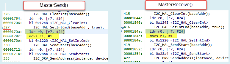

bosleymusic_com
Look at the assembly...bingo! Maybe....?
The question is, how do I change it?

Jorge_Gonzalez
Hi Donald:
Yes, that must be the problem. This is what I get:
This code is part of the platform library, so you should look there instead of your application. Do you remember changing any project setting of the K22 KSDK library (e.g. optimizations)?
Also, notice that in my case the MasterSend() code calls the API at line 327, while in your case it is missing.
Regards!

bosleymusic_com
I rebuilt the library and the i2c master driver c file showed up as modified upon rebuild. Everything is working now. Thank you.
