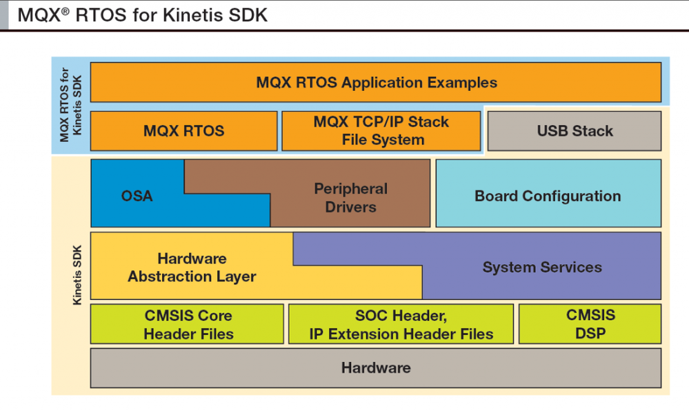

ivadorazinova
Hi Mark,
Yes - structure for MQX RTOS for KSDK is here:
I can recommend you Freescale MQX RTOS for Kinetis SDK User's Guide, which is actually located at C:\Freescale\KSDK_1.1.0\rtos\mqx\doc
and other guides, which can help you.
I hope this helps,
Have a great day!

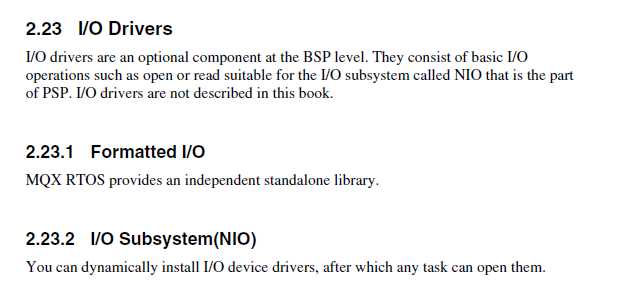

M_Grillo
Hello Iva,
Thanks for the reply. 2.23 states: NIO “I/O drivers are not described in this book”. The elusive I/O drivers and I/O Subsystem(NIO) documentation is what I’m in search of.
Mark
