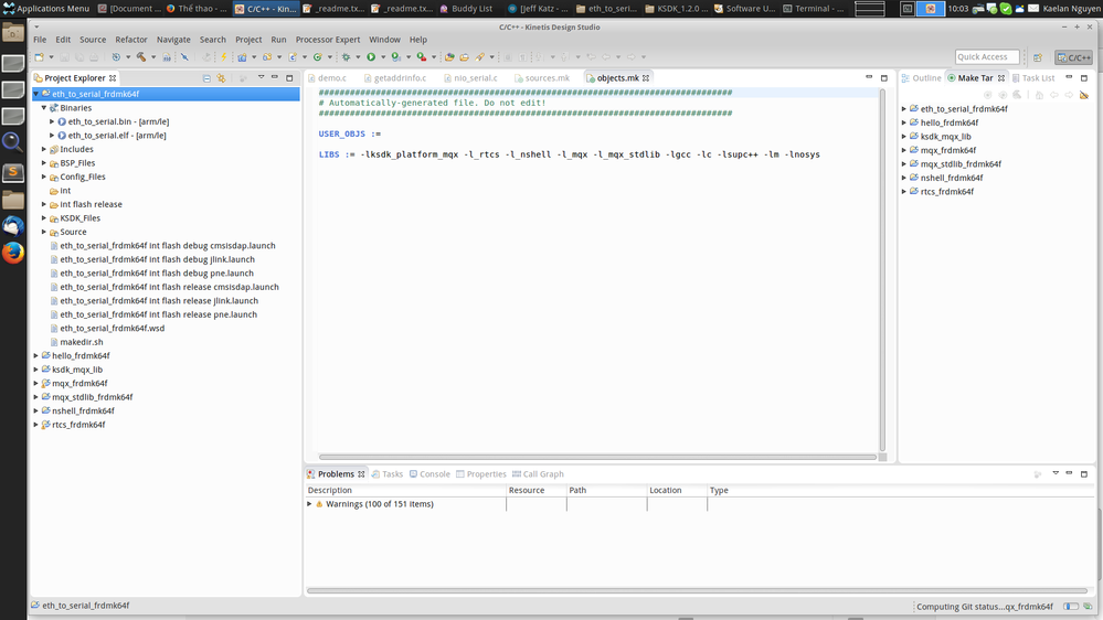

Im working with Kinetis SDK 1.2 and the FRDMK64F Board. I could successfully build the hello sample and flashed onto the board before. Everything were fine.
But since yesterday when I try to build eth_to_serial sample located inside middleware folder.
The output .elf gets really huge.
arm-none-eabi-size --format=berkeley "eth_to_serial.elf"
   text       data        bss        dec        hex    filename
  81620       1304       4992      87916      1576c    eth_to_serial.elf
Finished building: eth_to_serial.siz
I can't figure out what I have changed to cause this. Now everything I build are about 50MB or more, even the hello sample I built before.
Did I accidentally delete some flags of the makefile?
I tried to strip the elf File and flashed onto the board, but it seems to be wrong. The Board return fail.txt "RESERVED BITS".

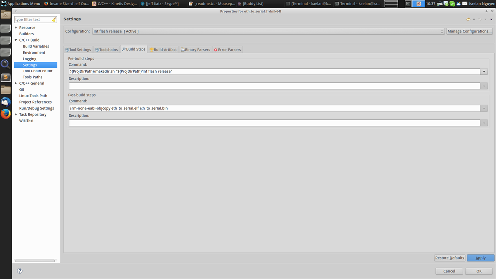

Yes, I built the sample as the readme told me to do. I actually could build it properly and flashed on board, which means all the libs were build correctly.
Then I added "objcopy" to the build steps under project properties so that I get a .bin file to flash. I also wanted to changed some function to use dhcp instead of staticip. After those changes, I tried to build and get that huge size of .elf. I cant remember what else I've done to cause this.
