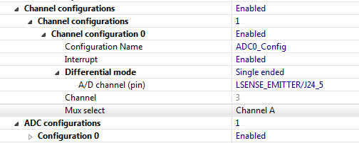

Since I'm not that familiar with the ADC in the Kinetis line, maybe I'm asking both.
In the fsl_adc_driver.h file, it says: "chnGroup Selection of the configuration group." The the PE menu below
does the chnGroup refer to the Channel configuration (line3) or the ADC configuration (last line)?
If it's referring to line 3, then when is the ADC configuration parameter used?

kerryzhou
Hi David Pfaltzgraff,
      Yes, you are right!
      chnGroup refer to the Channel configuration.
      ADC configuration parameter is used in the ADC_DRv_Init,  if you generate the code , you will find the adConv1_InitConfig0 is used in the init code, just like the following:
    Wish it helps you!
    If you still have quesiton, please contact me!
Jingjing
