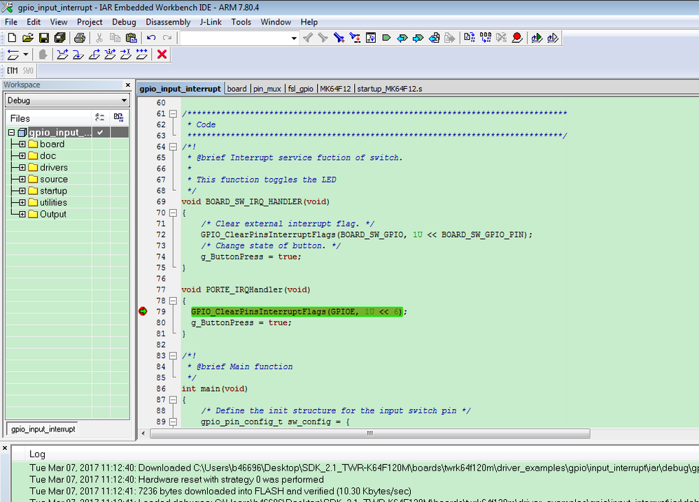

kerryzhou
Hi Sandeep Thota,
  KSDK1.2 is very older, please download the newest KSDK2.1-TWR-K64F120M code from this link:
Welcome to Kinetis Expert | Kinetis Expert
Click build an SDK, and choose the board as TWR-K64F120M, generate the code and download it.
We can modify the SDK_2.1_TWR-K64F120M\boards\twrk64f120m\driver_examples\gpio\input_interrupt
Add PTE6 input falling interrupt code:
void PORTE_IRQHandler(void)
  GPIO_ClearPinsInterruptFlags(GPIOE, 1U << 6);
  g_ButtonPress = true;
In main function:
    gpio_pin_config_t pte6_config = {
        kGPIO_DigitalInput, 0,
    PORT_SetPinInterruptConfig(PORTE, 6, kPORT_InterruptFallingEdge);
    EnableIRQ(PORTE_IRQn);
    GPIO_PinInit(GPIOE, 6, &pte6_config);
Then, after you pull down the PTE6, you will enter the PTE6 handler.
I also attach the gpio_input_interrupt.c for your reference, you can unzip it to folder : SDK_2.1_TWR-K64F120M\boards\twrk64f120m\driver_examples\gpio\input_interrupt
Wish it helps you!
