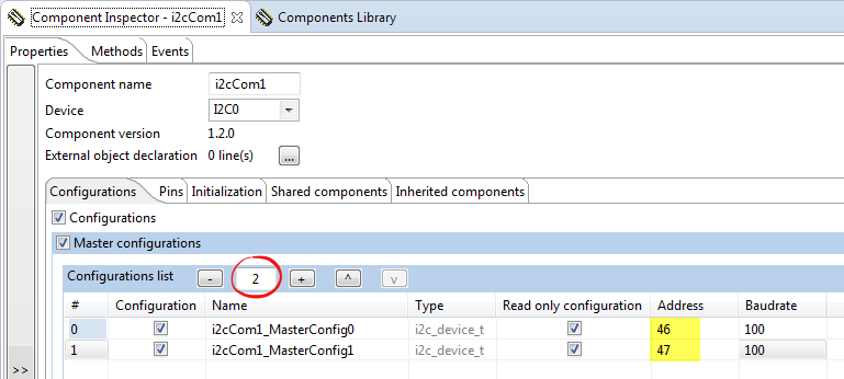

I need URGENT help! I have in my circuit 2 i2c-based digitial rheostat with the address 46 and 47. I use Kinetis design studio, ksdk1.2 and processor expert (bare metal). When I communicate with just one of the rheostat, everything works fine; i can set the resistance of the rheostat without any problem. However, when I try to set the resistance of the 2 rheostat consecutively, only the first one works, while the other isn't responsive at all. To mention is that the address of the first rheostat is set by using processor expert. In order to switch to the second rheostat I use the routine I2C_HAL_SetAddress7bit. It doesn't matter, which the rheostat I address first (using processor expert). The first one always does what it should while the 2nd doesn't.
Hope someone can give me an advice.
thanks

Hello hung Iam:
The API I2C_HAL_SetAddress7bit is not useful in this case. That API sets the listening address for slave mode, but in this case the MCU is in Master mode.
Instead you need 2 Master configurations in the fsl_i2c component:
Then you can call I2C Driver Send or Receive APIs using the corresponding master configuration structure (i2cCom1_MasterConfig0 or i2cCom1_MasterConfig1).
Regards!

Hi Jorge,
thanks a lot for the absolutely right advice. You have been a great help!
