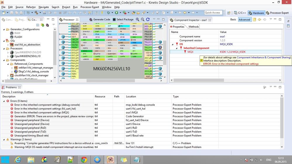

Hello
I used PE+Kinetis SDK 3.0
On a tab of a pleblema there are mistakes.
But I can't understand what a problem.
Prompt in what a problem and how to solve its?
I pritlogat the project to discussion.
Original Attachment has been moved to: tt4.zip
785 Views
Hello Prof,
In the MQX_Standard mode ,  please try delete the "fsl_debug_console " component .
Refer to Building a MQX Standard project with PE and KSDK  .
Hope it helps
