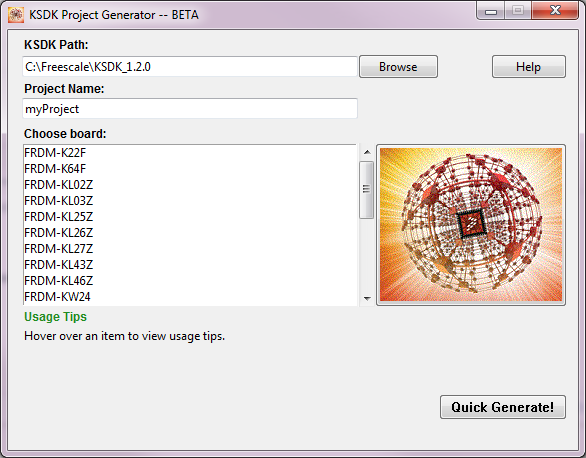

ivadorazinova
Hi Jairo,
can you show us the problem (attach screenshot) are you facing?
I also use Win7 64bit and on my side is without problems:
Thank you,
Iva
4,582 Views

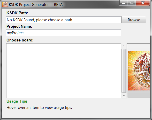

jberri
Thank you Iva for a very fast response.
Here is a screen capture:
The same executable works OK on another Win-7 -64bit.
The problem is on a Lenovo laptop.  I have been switching screen resolutions but no improvements.
4,582 Views

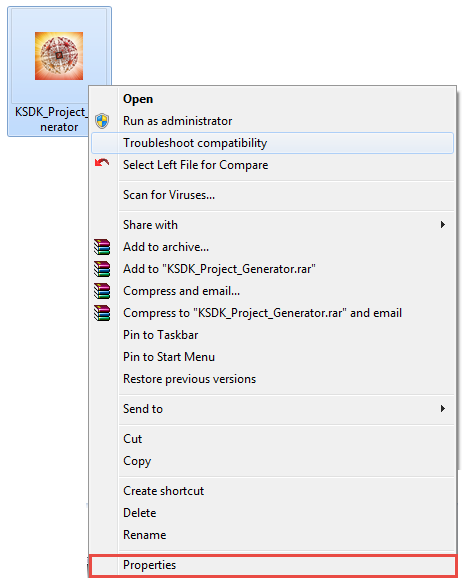

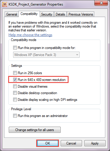

ivadorazinova
Hello Jairo,
please, what is your screen resolution?
Please, try this option for the application:
  • Right click on the application and choose Properties
  • in tab Compatibility please choose resolution 640x480
  • execute the application again
Please, let me know, if it helps you.
Iva
4,582 Views
jberri
Thanks Iva,
I tried the 640x480 earlier.  The screen looked horrible but the problem iwa the same.
I have also tried changing the screen resolution but it did not help.
