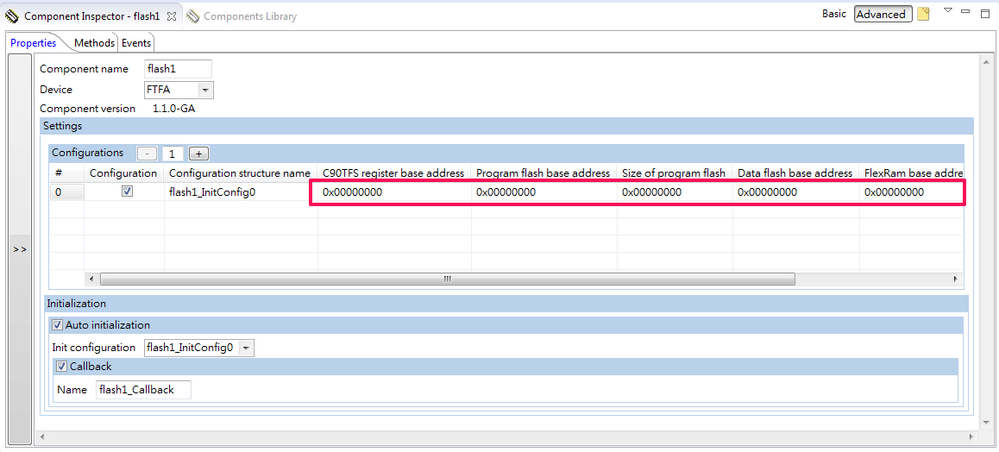

I use KDS 2.0.0 + KSDK 1.1.0 and enable Processor Expert to develop FRDM-K22F.
How to fill the parameter in PE Component Inspector?
And how to use API to read/write internal flash?
Thanks!

ivadorazinova
Hello Tang wang,
you need to know (from linker file or the manual) where at the address the area of the flash memory starts and its size and these values you fill to properties in flash component.
I recommend you to go to folder of KSDK, e.g. C:\Freescale\KSDK_1.1.0\platform\drivers\src\flash\C90TFS
and here you have a user manual for Standard Software Driver for C90TFS/FTFx Flash.
I hope it helps you,
Iva

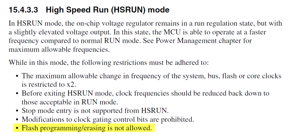

Tonkabot
Hi Jorge,
   I am using the MK22FN512xxx12 part, and I am running it at 120Mhz.
I have tried to use the PEX components (the intFlash kinetis component) to program my calibration data into a single 2k page, but I get nothing but errors.    I see here that you say The K82 cannot be flash programmed in HSRUN mode (150Mhz),  and I suspect that this might also be my problem.  I can't find where the reference manual says anything about there being a max speed.  I am running in PEE MCG mode with a 120Mhz core, 60Mhz bus, and 24Mhz Flash clock  (which sounds okay to me)

Jorge_Gonzalez
Hello Brynn Rogers,
Indeed, flash programming is not allowed in HSRUN mode. This is mentioned in the K22FN512xxx12 Reference Manual:
As workaround you can have a clock configuration for max speed (120 MHz in HSRUN) and another for RUN mode (80 MHz). Change to the 80 MHz clock configuration when writing to flash and then back to 120 MHz.

Tonkabot
Thanks, Jorge,
    It would be really really helpful to anyone who is trying to write to flash that has not memorized the reference manual that it would mention this in chapter 29, the Flash Memory module (FTFA) portion of the Reference manual.
  Or if the error message number returned by the PEX code (or fsl_flash.c code) would come right out and say that the clock is too high....
