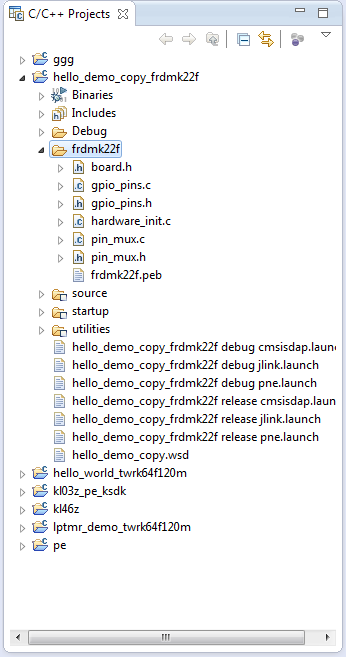

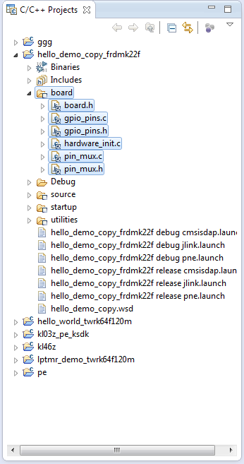

The procedure that Iva describes is basically correct, but it does not carry it far enough. I need to be able to move the project to any file structure on any computer that I want. This totally removed it from any dependencies of the KSDK structure. The following finally worked for me.
1. Use the script that Iva provided to generate a parallel project. As mentioned this is still dependent on the KSDK structure. So...
2. For each of the source folders (those containing .c and .h files), create a new folder by a different name. For example, for the "Sources" folder, create the new one as "Sources2".
3. Now for each file within the original folder, look at the "properties" pane to find the true path to the file and then going to the new folder, use the Import=>File System option to go to the true path and select the corresponding files. When selecting the files, go to the "Advanced" panel and make sure that "Create Links in Workspace" is NOT selected. Once all of the files have been copied into the new folders, delete the original folders a\nd rename the new folders to the original names.
4. AT this time do a build. It should be OK, but if not go back and copy in the correct files. This is an iterative process and once you have a clean compile, export this intermediate result to an archive file. (Just in case you need to come back to this point.)
5. Now go into the project properties and edit the C/C++ Build=>Settings=>Cross ARM C Compiler=>Includes to eliminate the relative (../) references. This takes a little work, but it is best to replace the strings of "../../../../../..." with ${KSDK_PATH}. Again this is an iterative process and may take some figuring out to get it right. Check it out by doing a build. Once you have it right, again make an archive for sanity.
6. Now go into the project properties and edit the C/C++ Build=>Settings=>Cross ARM C Linker=>Libraries (and Miscellaneous) to edit out the relative paths in the same manner. Check it out by doing builds. Once you have this right, generate the archive file as before.
7. Now, if you've done it right, take the archive file and unzip it to a new location. If you've done it right, all relative links outside of the project have been removed and the project should compile and run. If not, dig down and find the spots you've missed and go back to the appropriate step. (Remember those archive files we made along the way?).
Although it is tedious, this has worked for me and now I am free to change anything within the project without worrying about changing any of the original code.
Note: I'm OK with KSDK header files remaining in the KSDK area as I should not be changing those. This is also true of any driver files that I should not be changing, but I do know that some of them may get copied over in the process. If this is a concern, it is now a minimal effort to clean up.
I hope this lengthy process helps others in getting their projects going as well.

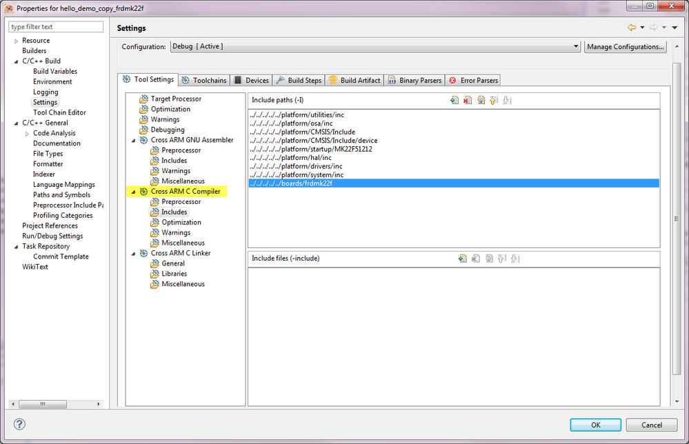

I have several problems with this approach.
The first is that there is heavy use of relative paths. For example, the include directive of:
  ${ProjDirPath}/../../../../../../config/mcu/mk22f120m
more or less restrains me to staying within the directory structure defined by Freescale and the KSDK. I want to move the project into my own area such as C:\Projects\xxx.Using this directive as an example, the system would try to search for a header file at C:\config\mcu\mk22f120m\ which does not exist.
The second is the use of virtual folders. As I understand it, this is a link to the original file. A change in that file for this project would make the same change in another project which may have undesirable side effects.
Don't get me wrong. I think the concept of the virtual folder is good in that it saves space and time in addition to enabling code reuse. However, in my case, I would like to be able to extract the project in its entirety from the Freescale KSDK directory structure and put it where I can work with it, put it in version control, etc. (Note that the header files and libraries should remain where they are. I am speaking of the code unique to this specific project.)
In looking at some of the newer work, for example code generated by PE in the most recent version of KSDK, instead of using relative paths the ${KSDK_PATH} construct is used so that a project is more portable. For example, I can export the entire project through an archive file and then import it to an entirely different location and have it work. There is no need to clean up a lot of paths which is prone to errors.
I think a good example that shows what I mean is the tutorial found at How To: Create a New MQX RTOS for KSDK Project in KDS. The few cases where the ..\ construct is used is entirely within the project and even those could be replaced with the ${ProjDirPath} and thus be avoided completely.

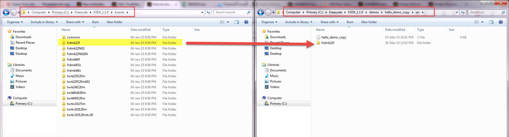

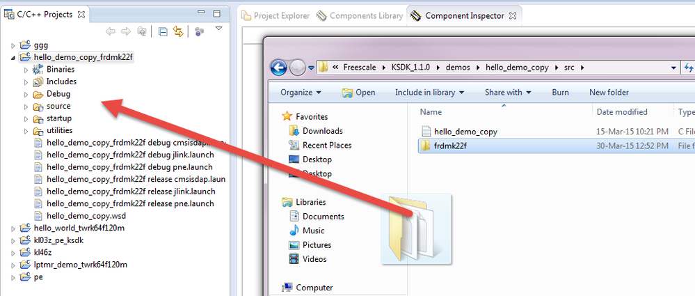

Hi David,
yes, you are right. If you create a copy of the example, you must observe certain rules.
If you need to work with specific files, please just put them into your project.
So, e.g. if you want to modify board.h, etc in boards folder,
please go to folder boards, C:\Freescale\KSDK_1.1.0\boards and copy frdmk22f to your project folder.
After that don´t forget to delete these files in KDS and put there new ones.
and rewrite paths in KDS for Compiler.
You can rewrite the files by this way.
Best Regards
Iva
