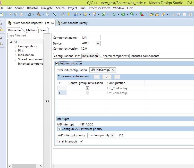

I am trying to read ADC value from a pot.
The chip configuration is MK20DX256VLL10 and software i used KDS3.0+ KSDK1.2+PEx.
I am sure there is no problem with hardware since it works in my old code with KDS2.0+PEx.

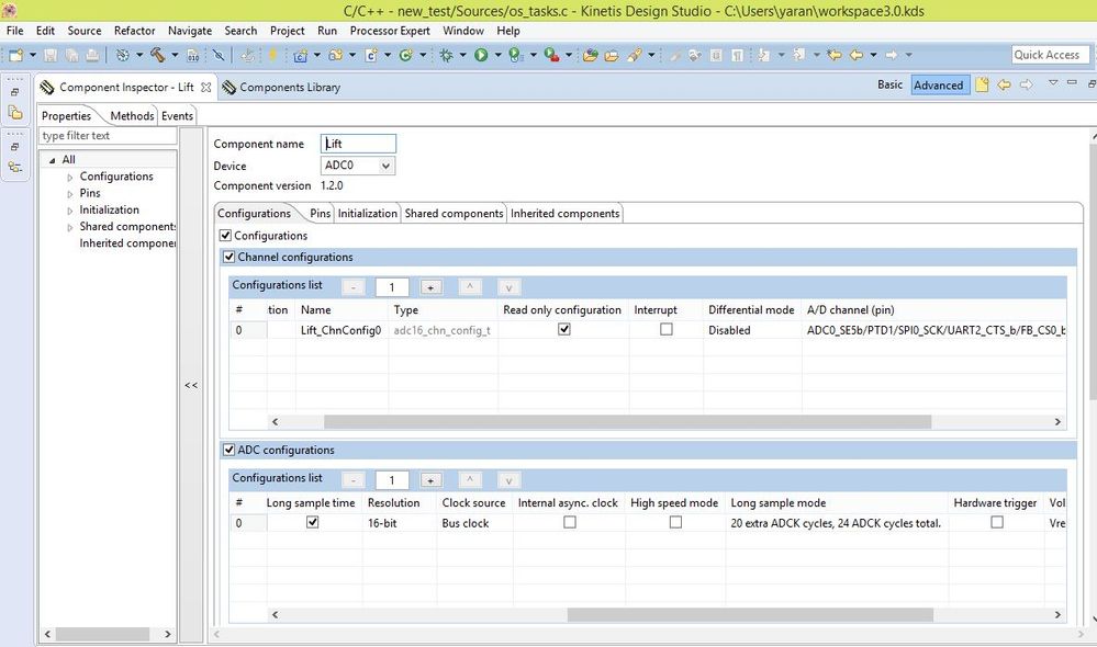

So I am thinking my ADC configuration and code sequence might went wrong. I checked
example code and couldnt figure out what went wrong.

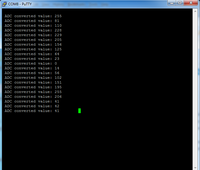

Every time i run the code, the ADC value jumped from 255 to 0. It made no difference when I plug and
unplug pot. I have attached my code project and configuration screen shot.
Could someone help? Thanks in advance.

Hello Yaran,
Ok, i create one ADC sample project on SDK1.2+PE, while for i have not the MK20DX256VLL10 chip , i test on K21D50,
while it is the same , please see the attachment . And when i change the resistance values , the ADC will changed , this screenshot
is the result i test on my side :
- I checked your project about the configuration of fsl_adc16 component , it have no error , my project is  the same with yours (except the ADC chn).
So , i think you should be sure what about your ADC signal , you'd better check it use the oscilloscope or other instruments .
And also i don't know whether is the reason of MQX , could you please first create one simple bareboard project , only add fsl_adc , like my project(or directly
copy my code ), test whether it can work well .
Hope it helps
Alice

yarannan
Hi Alice,
I got it working. The reason is beside of the code, i have to add another line of code to
configure channel (which is channel b in my project). I thought i set up pin at PE configuration.
Thanks for your helps though.
