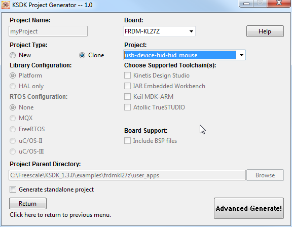

The test is based on FRDM-KL27Z, dev_hid_mouse_bm demo. And before we modify the device stack, we have to clone a copy of this demo.

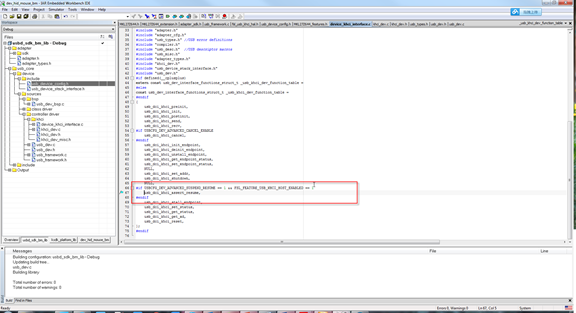

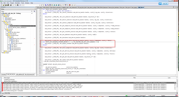

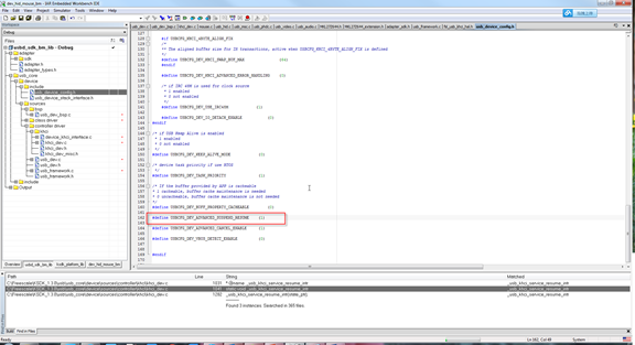

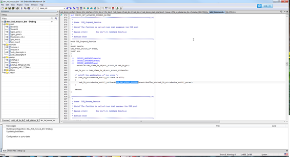

  1. Set USBCFG_DEV_ADVANCED_SUSPEND_RESUME to 1 to releases APIs related with suspend and resume features.
But we will have the following errors after compile, that is because remote resume function is not supported by KL27.
so we should disable it for this device, with the help of #if USBCFG_DEV_ADVANCED_SUSPEND_RESUME == 1 && FSL_FEATURE_USB_KHCI_HOST_ENABLED == 1. For example, like below:

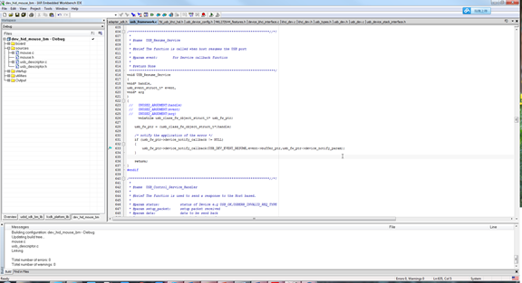

2.Further implement USB_Suspend_Service() and USB_Resume_Service() to let them notify the upper layer application on the event of suspend/resume. With reference of USB_Error_Service()
and Don’t forget to add two more events for suspend and resume.

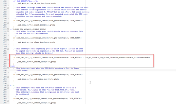

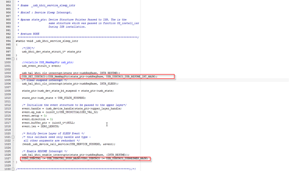

3.USB module has two types of resume interrupt , one is sync resume , issued by the bit of ISTAT[RESUME] bit, the other is async resume, issued by the bit of TRC0[USB_RESUME_INT], so we have to monitor these two interrupt status flag in the ISR, as below:
And so we have modify the resume and sleep interrupt services for supporting the async resume interrupt as below:

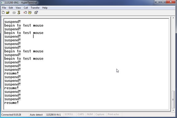

4.Modify application and add code to handle suspend and resume event, in this case, such kind of events are handled in USB_App_Device_Callback()

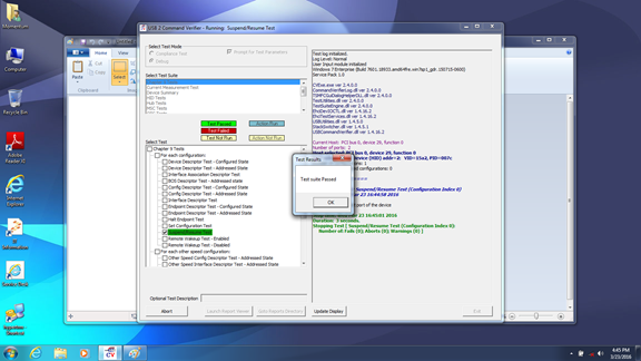

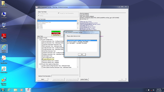

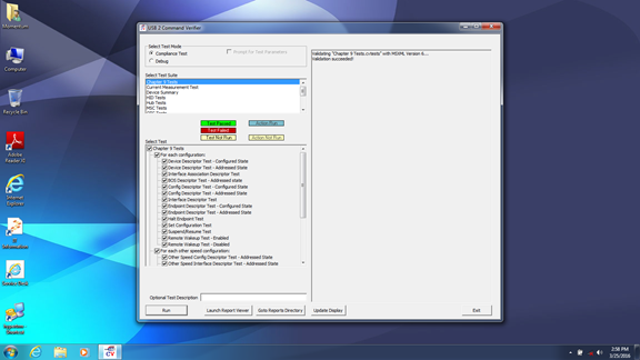

5.Verify the hid_mouse demo with USB 2 CV tool from usb.org
Select the FS device with VID 15a2 from the list.
Test passed!

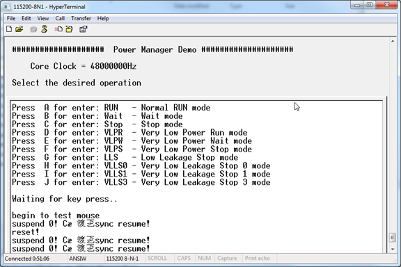

if you print some messages on the event of suspend and resume, you will see something like below from the Terminal channel.

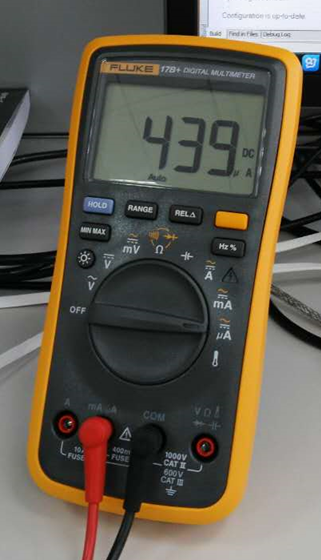

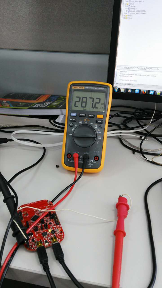

7.Test low power mode current:

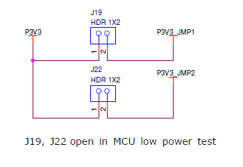

  Before test, please do the following modification to the FRDM-KL27Z board:
Please note, if your board has the following jumpers, no need to remove R7,R21 and R83, just keep J19 and J22 open during the test.
Select the low power mode you are going to test from the Ternimal:
Leave KL27 USB port (J10) open and power the board with USB SDA port, that would make the device enter suspend interrupt out of reset. And you may also see the current vary with power mode switch with the help of USB 2 CV tool. I have tested wait, stop and vlps modes, the current measured under these modes are shown as below:
Wait:
Stop:
VLPS:
So it is recommend using VLPS mode during USB suspend mode as it far below the suspend current specified in USB spec (500uA).
