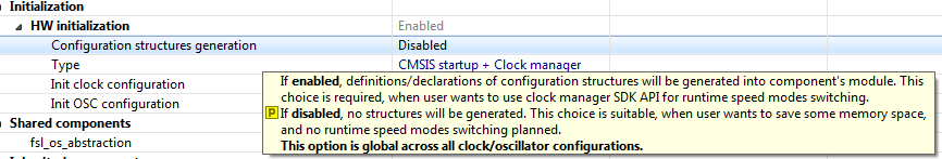

PEx KSDK project starts via CMSIS startup code always but it sets global variables for clock manager so there is no limitation in clock manager usage. Startup configuration is generated into system_<DEVICE>.h corresponding system_<DEVICE>.c is left in KSDK without any modification.
PEx KSDK project with and without clock_manager. You can find more details here: KSDK 1.2.0 and MKV30  :How to remove osa1 if i dont want any OS??
In clock manager component you can also control generation of configuration structures.

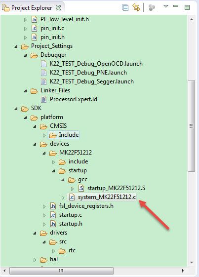

jeremyzhou
Hi Prof,
For instance, in the K22 demo, you can find the SystemInit() in the system_MK22F51212.c, and this function is applicable to configure the clock mode.
In the system_MK2251212.h, it contains the corresponding values of the different clock modes for the developer to choose.
Ping

Hello Prof,
- After configure the CLOCK on PE, generate code ,you can find the configure about MCG SIM register on the file "clocMan1.c" :
...\Generated_Code\clockMan1.c  -> clock_manager_user_config_t clockMan1_InitConfig0 ;
- Use the function of "CLOCK_SYS_Init()" to initialize the clock ,  on the file :
...\SDK\platform\system\src\clock\fsl_clock_manager.c
Hope it helps
Alice
