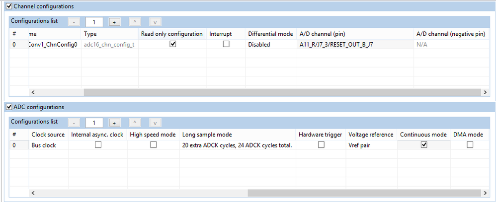

I am trying to set up the K24 for single, software triggered ADC sampling.  I have looked through the ADC example in the SDK for this board, as well as a couple other user examples, and tried to adapt them as best I could to what I want to do.  Below is some modified code from the ADC example.

The actual configuration should be handled by the processor expert, so I deleted the initialization lines.  All of this code runs fine, but when some time after the method returns, the program gets stuck in the default ISR.  Here is a code snippet of my main where I call the ADC sample method, and the assembly routine starting at "read2"

Basically, I am running an assembly routine, and at several points I need to return to main from the routine to grab an ADC sample.  The program is able to run the ADC code and re-enter the assembly routine at the label "read2" using branch and link, but then a few instructions after "read2" the program gets stuck in the default ISR.  I'm reasonably sure the assembly code has nothing to do with it, since the instruction where it hangs is the first nop.
Here is the config screen for the PE fsl_adc16 module:
