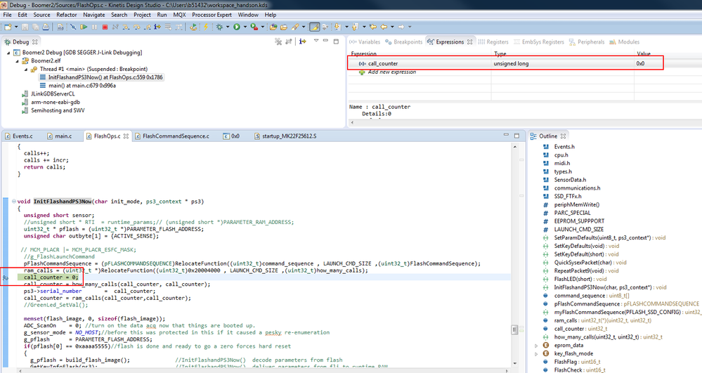

Hello DAVID,
I have received your project from email.
- In the project , relocate the fucntion "how_many_calls" to 0x20004000,  i only changed one place, then it can work well.
i changed
   call_counter = ram_calls(call_counter);         to
  call_counter = ram_calls(call_counter,call_counter);
then i build and debug , this funciton can work well , please see the screenshot when i debug , pay attention the variable of " call_counter" .pastedImage_1.png
- In the project you send to me , i have not fund the use the function about "FlashCommandSequence" after you relocate it .
Hope it helps
Alice
