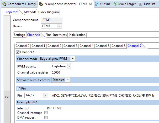

I have been struggling all day so far trying to get PWM to work on my FRDM-K64F.  I am using a FRDM-K64F with KDS 2.0 and KSDK 1.1.  My initial attempts at following app notes and adding the PWM code to my application failed, so I decided to create a new project from scratch and add PEx support to it.
All of the examples I see online make references to a PWM PEx component.  I don't have such a component in my list, but I do have Init_FTM.  I figured that this should also suffice.

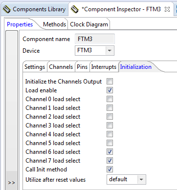

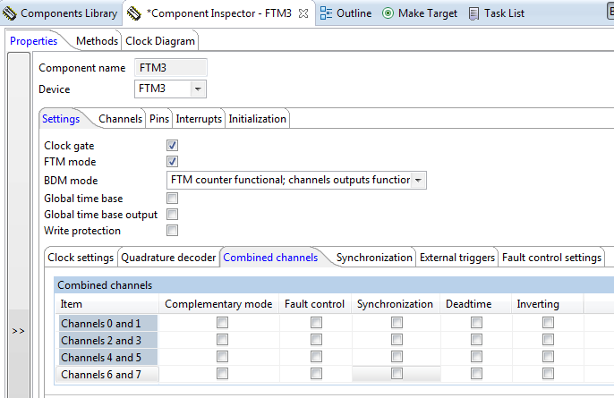

I have set all of the properties for this component to try to get PWM working, but so far I have been unsuccessful.  I have tried all different combinations of settings that make sense (to me), but in the end, my PWM pins (PTC10 and PTC11) just go high and stay high when I run my application.
Here are settings that I thought would work:
Hopefully I'm doing something silly that someone will be able to point out and explain.  Any comments would be really appreciated!

I'm glad I found this post from yesterday:
fsl_ftm bug on 100Hz?
Apparently, fsl_ftm only supports one PWM channel.  It would be really nice if the PEx developers would either put this in the GUI if they *know* that it will only support one channel, so devs using the tool aren't wasting time wondering why a feature that should work, isn't.

I have noticed that a lot of people are using fsl_* components (what is their significance in the Kinetis ecosystem?), and I also just noticed there's a fsl_ftm component in PEx.  I'm going to start playing with that component now to see what happens.
