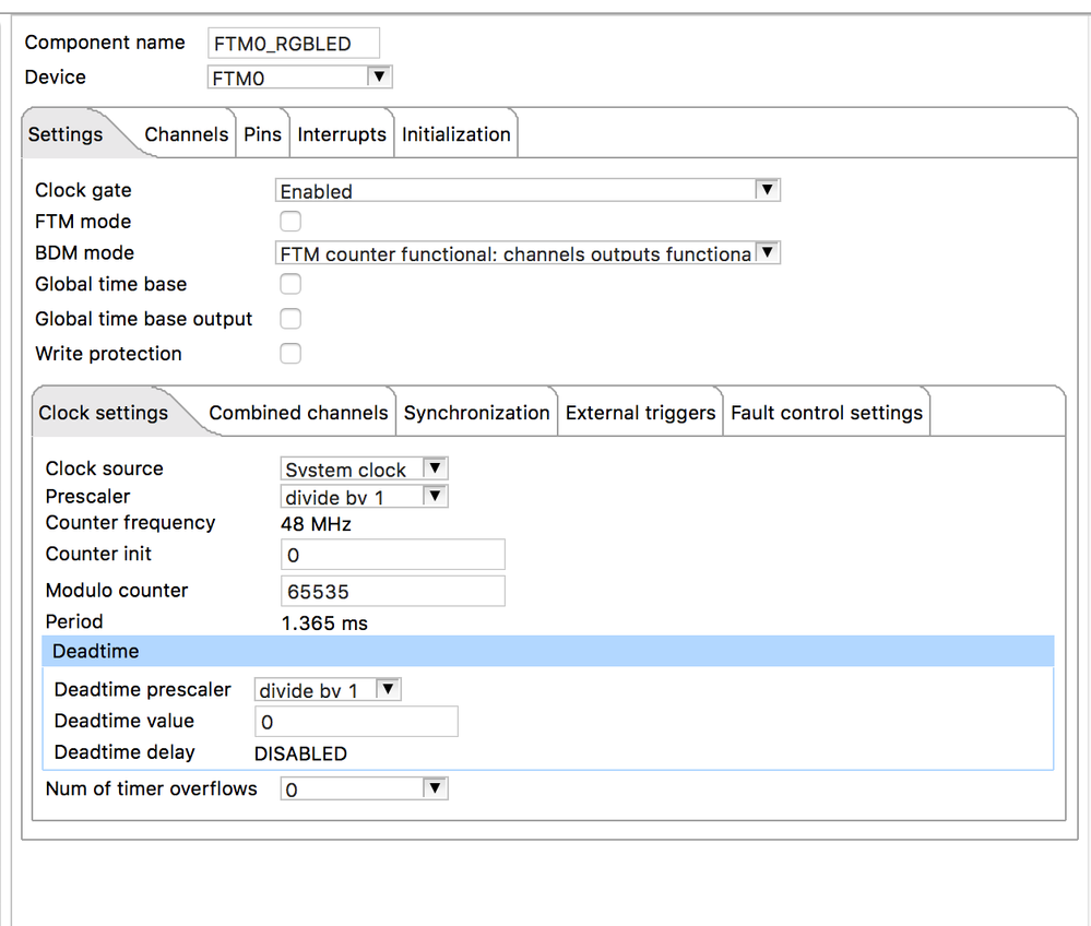

The FTM setup seems pretty basic

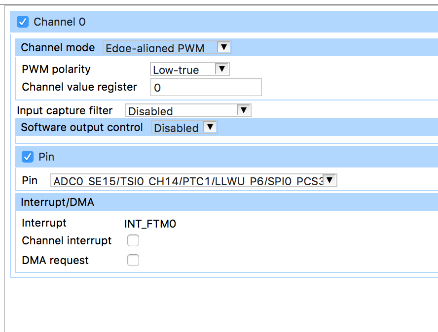

With 3 channels set up for the R G B diodes of an RGBLED

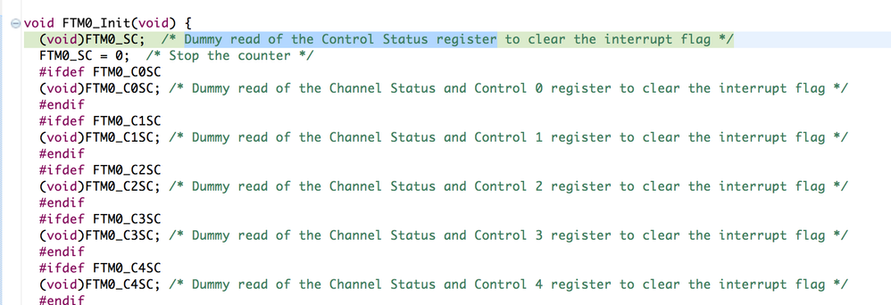

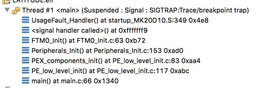

The crash happens on the very first line of the FTM0_Init....
I have another demo project based on a different chip model  with so far as I can tell identical FTM settings...  The generated code for that one is different:-
void FTM0_Init(void)
  /* SIM_SCGC6: FTM0=1 */
  SIM_SCGC6 |= SIM_SCGC6_FTM0_MASK;
  (void)(FTM0_SC == 0U);               /* Dummy read of the FTM0_SC register to clear the interrupt flag */

Hello Kris,
Have you enable the FTM clock ? If not ,please enable it first like this :
And if it still can not work well , please tell me the version of your KDS , and send your project to me ,
i will  check the problem for you .
