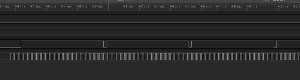

Based on the example provided, I attempted to replicate a similar setup using the SAI and EDMA HAL in KSDK1.3 directly for SAI transmit only today. I have attached my test project which produces a bit clock and (incorrect) frame clock, but does not seem to trigger the DMA channel to start moving data.

Today, I extracted the "sai_dma_test" method from the validation code provided by Kan​ and set it up in a KDS project targeting the FRDM-K64 with only it's necessary dependencies, and I also set up UART to act as a terminal. I got the exact same results with this method as I got interfacing with the KSDK 1.3 SAI / EDMA HAL in my previous post. PTC1 remains low while PTC2, PTC3 show a valid frame sync and bit clock signal.
I have attached the complete KDS project demonstrating the issue.
