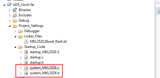

3)If you do not want use the ksdk driver,  in the file of "system_MKL25z4.c" and "system_MKL25Z4.h" have defined all of the clock mode ,
you can refer to :
you can refer to :
