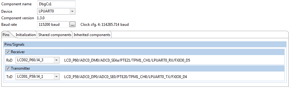

This is the processor expert for the debug console component, for the pins (not sure why the debug console needs pins).
And it says it's auto initialized. So I am trying to simply display the value on my computer (is the debug console even the best way to do this?).
The debug console requires pins because it outputs the console data over a peripheral, that usually being a serial interface (UART). Does your board have a dedicated UART for debug purposes?
