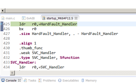

I have very simple working DAC baremetal demo that is working on FRDM-KL25 board.
The tools are KDS v3.2 and KSDK v2
I'm trying to use it also on FRDM-K64.
The DAC init function is
void DAC0_init(void) {
       SIM->SCGC6 |= 0x80000000;   /* clock to DAC module */
       DAC0->C1 = 0;               /* disable the use of buffer */
       DAC0->C0 = 0x80 | 0x20;     /* enable DAC and use software trigger */
Executing "DAC0->C0 = 0x80 | 0x20;" causes the program jump to HardFault handler.

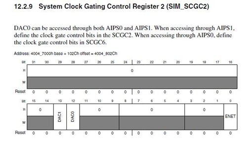

I solved this problem by using SCGC2 register.
