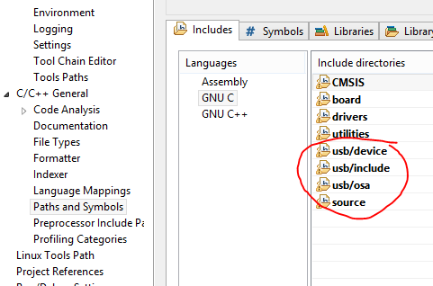

I copied the files from the middleware folders and example project into my project and added them as include paths for the compiler:
C:\Freescale\SDK_2.2_MK22FN512xxx12\middleware\usb_1.6.3/device
C:\Freescale\SDK_2.2_MK22FN512xxx12\middleware\usb_1.6.3/includes
C:\Freescale\SDK_2.2_MK22FN512xxx12\middleware\usb_1.6.3/osa
C:\Freescale\SDK_2.2_MK22FN512xxx12\boards\frdmk22f\usb_examples\usb_device_composite_cdc_msc_lite/bm

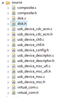

2. Copy application files from bm folder (boards\frdmk22f\usb_examples\usb_device_composite_cdc_msc_lite\bm)  to source folder. After this the source folder will be like:

5. Add include directories to settings

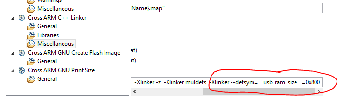

6. Change this in linker file (MK22FN512xxx12_flash.ld):
7. Add these preprocessor definitions:
8. Add this option to linker settings:
   -Xlinker --defsym=__usb_ram_size__=0x800
Now the new project is ready for build and you have the usb example project as a standalone project.

As a related question, do you know what the '-Xlinker --defsym=__usb_ram_size=0x800' linker option does?  I was unable to find that symbol in the linker script or anywhere in the project.
2,339 次查看
visakhanc
Nice to know it helped you! The linker option '-Xlinker --defsym=__usb_ram_size=0x800' was found in the project settings of that usb example. I also didn't find the use of it. I think some other usb examples may be using it.
