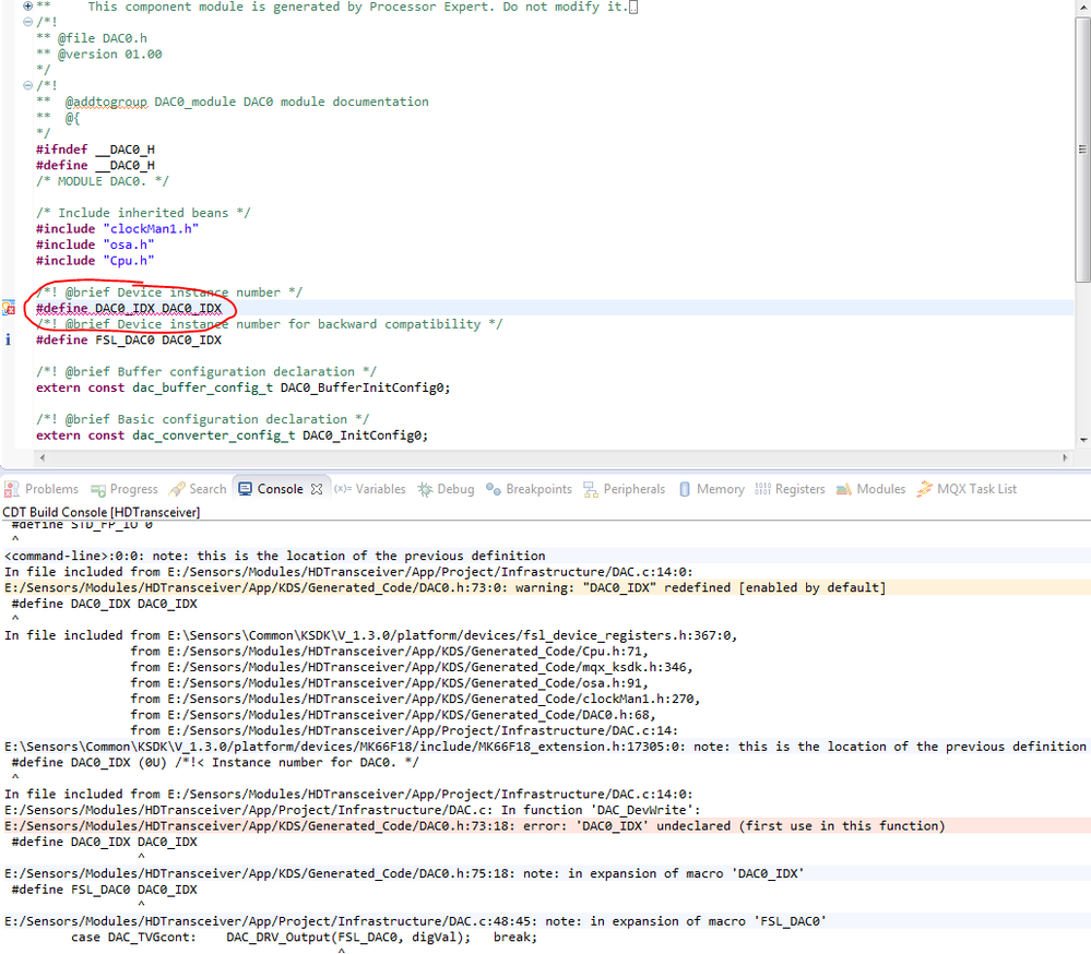

I am in the process of upgrading a project from KSDK 1.2.0 to KSDK 1.3.0 (KDS 3.0 with Processor Expert). However, I got some trouble with the code for the fsl_dac component that is generated by Processor Expert. Everything was working fine with KSDK 1.2.0 but now there is a strange define, that leads to an error:
Is there a bug in the code generation? My workaround now is to delete this define and deactivate Processor Expert code generation for this component.

Hello Iva,
while generating an example project for you, I found out what the problem is. The "Component name" in my project was the same as "Device" - it was "DAC0". That was not a problem until now, but for KSDK 1.3.0 the code generator used this name to generate the define that was causing trouble. Now I changed the name to daConv0 and everything seems fine:
