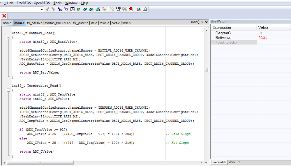

I am running a freertos on my KL27, then I have two features that using the ADC, one is the temperature sensor (SE26) and the other is reading my battery level (SE9). So in my code, I am doing the mux aternative, i need to provide a short time after each read in order to get the correct value, otherwise, my value comes back negative.
In addition, i read this post and tried both solution, but i still have the same incorrect result. Do you have any other tips? Did I miss something? Please let me know what other information you need to understand more clearly.
Thank you.

Hi Xiangjun,
Please see my functions below. I do the ADC_Init in the main at the beginning, then I run my battlvl_read() and temperature_read() in my other task alternatively. I configured my reference voltage source to Valt, I also tried to connect my Vref to VDD as well. But my temperature read became negative value with the taskdelay. See result in the images.

uint32_t BattLvl_Read()
    static uint32_t ADC_BattValue;
    adc16ChannelConfigStruct.channelNumber = BATTLVL_ADC16_USER_CHANNEL;
    ADC16_SetChannelConfig(ADC16_BASE, ADC16_CHANNEL_GROUP, adc16ChannelConfigStruct);
    vTaskDelay(15/portTICK_RATE_MS);
    ADC_BattValue = ADC16_GetChannelConversionValue(ADC16_BASE, ADC16_CHANNEL_GROUP);
    return ADC_BattValue;
int32_t Temperature_Read()
    static uint32_t ADC_TempValue;
    static int32_t ADC_CValue;
    adc16ChannelConfigStruct.channelNumber = TEMPSEN_ADC16_USER_CHANNEL;
    ADC16_SetChannelConfig(ADC16_BASE, ADC16_CHANNEL_GROUP, &adc16ChannelConfigStruct);
    ADC_TempValue = ADC16_GetChannelConversionValue(ADC16_BASE,ADC16_CHANNEL_GROUP);
    if (ADC_TempValue >= 917)
          ADC_CValue = 25 - (((ADC_TempValue - 917) * 100) / 204);                // Cold Slope
    else
          ADC_CValue = 25 + (((917 - ADC_TempValue) * 100) / 219);                // Hot Slope
        return ADC_CValue;
With time delay, ADC value reads properly on both functions.
Without the time delay, the temperature read became negative.
Please advise. Thank you.
Gilbert
