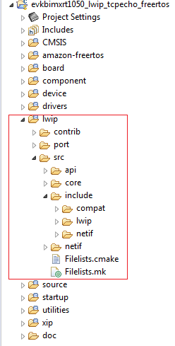

Organization of the LwIP stack
Let’s take SDK_2.6.1_EVKB-IMXRT1050 for example,
LwIP code in under SDK_2.6.1_EVKB-IMXRT1050\middleware\lwip
Port: This folder includes the adapter code which can make the LwIP stack run on the bare metal and FreeRTOS.
Enet_ethernetif.c/h: Adapt the LwIP stack to the underlying MCUXpresso SDK ethernet driver, provides ethernet interfaces , like  phy init and  ethernetif_input.
cc.c/h: provide typedefs, compiler hints for packing and platform specific diagnostic output.
Perf.h: architecture specific performance measurement, current the definitions is NULL, reserve for future use.
Src: This folder includes the latest stable LwIP 2.1.2 source code which can be downloaded from below link download.savannah.gnu.org/releases/lwip/
--api: netconn and socket API files
--core: LwIP core files
--include: LwIP include files
--netif:  network interface files

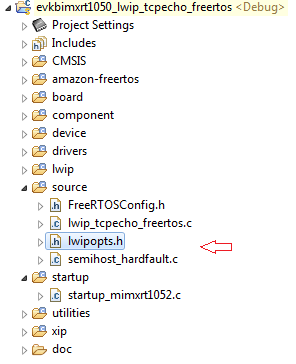

Configuration file is placed in application source folder: Lwipopts.h:
Lwipopts.h is a user file that you can use to fully configure LwIP and all of it’s modules. You do not need to define every option that LwIP provides; if you do not define an option, a default value will be used. Therefore, your lwipopts.h provides a way to override much of the behavior of LwIP.
