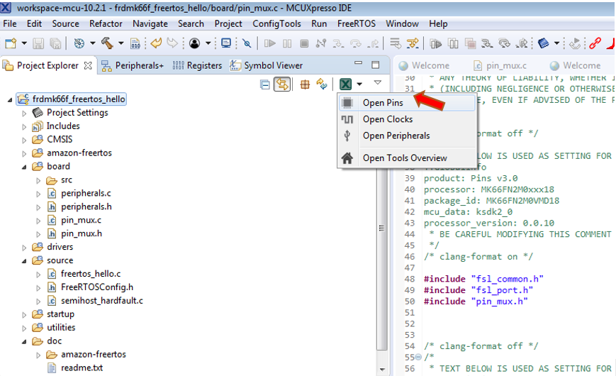

First, we need to have a working FreeRTOS project. Here we import the freertos_hello example into MCUXpresso IDE workspace.
To open the tool, simply right click on the project in Project Explorer and select the appropriate open command.

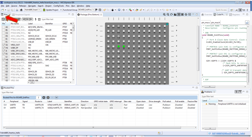

Then we can see the pin table, peripheral signals, package/pinout view, Routed pins view, generated code view.
Basic configuration can be done in either of these views Pins, Peripheral Signals or package. More advanced settings can be adjusted in Routed Pins view.

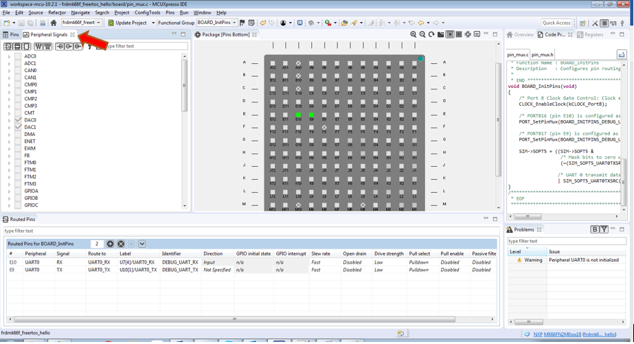

Beginning with Peripheral selection
In the Pins view on the left find a pin and peripheral signal in the table and configure the routing by clicking on the signal cell.
In this example, select PTC9.  Click into the cells to make them ‘green’
Select PTC9 on the Peripherals signals view,

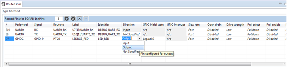

Routed Pins configure
Route the selected signal to the desired pin,and configure it in the Routed Pins view.

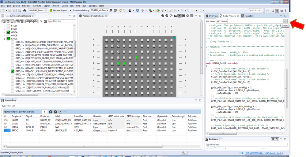

It is possible to easily identify routed pins/peripherals in the package using highlighting. By default, the current selection (pin/peripheral) is highlighted in the package view.
State Indicator of Pin Tool
Green indicates pin/peripheral is routed
Yellow indicates pin/peripheral is currently selected
Red indicates an error
Light grey indicates pin/peripheral is available but is not currently routed.
It is also possible to configure the pin electrical features. Use the table drop down menu to configure the pin. To configure pins, start from left to right—select the peripheral first, then select required signal, and finally select the routed pin.

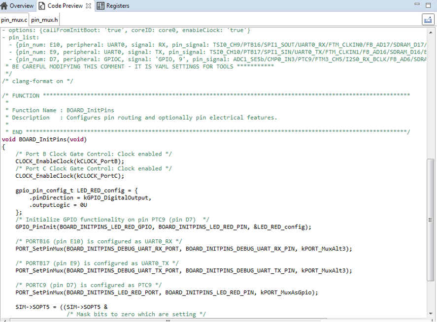

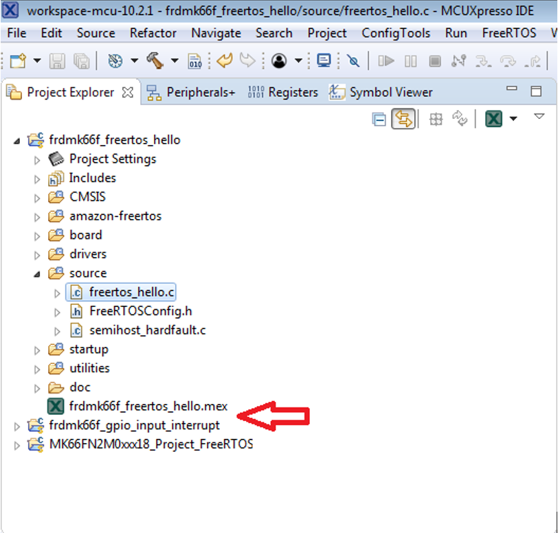

 The Pins Tool automatically generates the source code for pin_mux.c and pin_mux.h on the right panel of the Code Preview view.
The configuration will be saved into .mex file, see picture below
Export the code.
You can now copy-paste the content of the sources to the application and IDE. Alternatively, you can export the generated files. To export the files, select the menu  Export
Click Next and specify the directory, Click Finish to export the files.

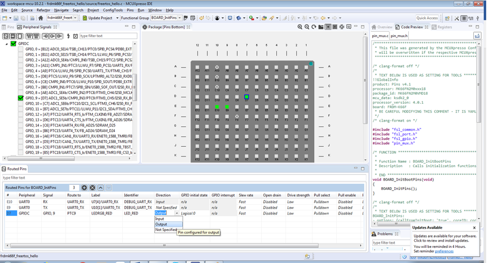

Integrate code the FreeRTOS task
In the source code, Board_InitBootPins() calls initial code in pin_mux.c/h
In hello world task, we toggle the configured pin
 * @brief Task responsible for printing of "Hello world." message.
static void hello_task(void *pvParameters)
    for (;;)
        PRINTF("Hello world.\r\n");
        /* Toggle LED. */
        GPIO_PortToggle(BOARD_LED_GPIO, 1U << BOARD_LED_GPIO_PIN);
        vTaskDelay(200);
Then run the example, we can see LED is toggled every 200ms.
