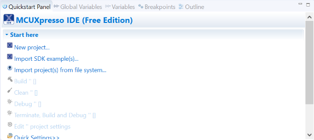

Is this related to Kinetis Motor Suite operation? If so you are using an out-date release. Please use the latest release of SDK and KMS to continue support. If it is not KMS related then the question should be asked in the Kinetis MCU community

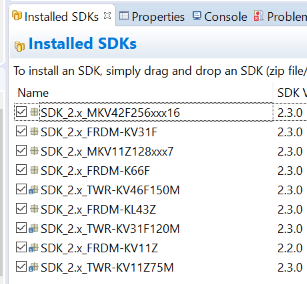

You will have better success with the MCUXpresso SDK demos for the KV31F MCU.  You can create and download a SDK package from kex.nxp.com.

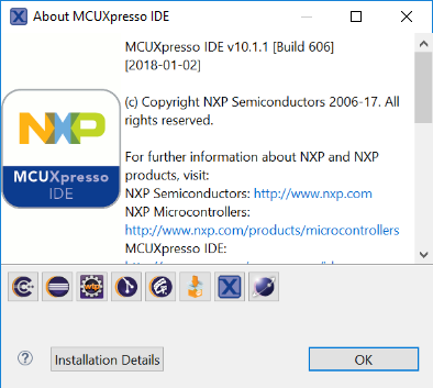

I also suggest you download and use the latest MCUXpresso IDE.
  Ónce you have loaded the IDE with the SDK archive package you can open the demo or driver examples.
I hope this helps.
