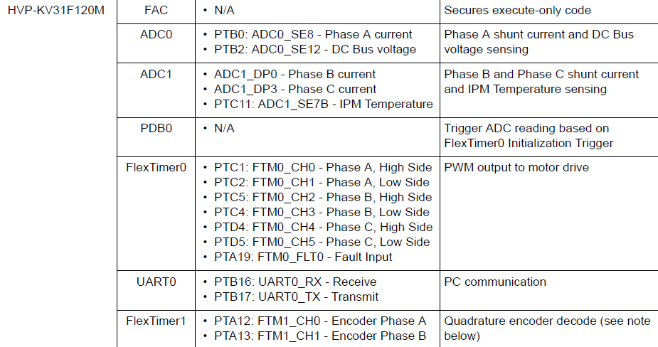

1) I_phC NetLabel is shown in the HVP-KV31F120M schematic on 2 pins,  54: PTB1 and 18:ADC0_DP0/ADC1_DP3?  It is not clear which specific pin I_phC is being measured on?
2) V_in is also shown being driven into 2 pins with 0ohm resistors both pin 27 and 28?  Any particular reason this is done?  Is the V_in measurement actually performed on both pins or just one?
3)  Can you provide some insight as to what is desired to be filtered out with the RC filters on the AN inputs?  All but the BEMF inputs all have a 100ohm / 2200pF RC whereas the BEMF inputs have a 100ohm / 390pF...reasoning for the difference?

1. The pins used for the ADC measurements are called out in kms_hw.h file as the channel to sample.  If you read through the Customer Hardware App Note, you will find examples for moving the ADC channels which should prove helpful for understand the pin mapping.  The channel to pin mapping is located in the KV31 Subfamily Reference Manual.
2. V_in is not used in KMS.  I assume this is here to support PFC applications.

A.  I am assuming the Appnote you are referring to is AN5254, "Adapting KMS for Custom Hardware"?  If that is it I am quite familiar with that appnote from and have already used it extensively to modify the HVP unit to handle 30A+ by modifying the OpAmp gains, shunts and replacing the 3Ph Inverter with the 30A version.  However this document does not help with my prior posed questions.
 B. There is no file in any of the projects that KMS Studio Generates for the HVP-KV31F that are called kms_hw.h?
Maybe you have a different KMS Studio than I have?  The only file that is produced that outlines pins is called hw_pins_init.h and this file does not provide any insight as to which specific ADCx Channel is being used for the various NetLabels/Parameters that are shown feeding into the ADC inputs on page 3 of the HVP-KV31F120M(spf-28269) schematic.
  It becomes quite challenging when as mentioned earlier I_phC is shown as a Netlabel on 2 different pins?  On top of that as mentioned earlier there is no where that I have been able to find in either the KMS PDF Documentation OR source code that identifies where the BEMF_A, B, C inputs are even used in the KMS/Sensorless algorithm.
I am familiar with Table 3-28 in the KV31F256 and 3-39 in the KV31F512 Ref Manuals and how to go about re-mapping pins and/or ADC inputs but when I can't find the BEMF_x variables/input anywhere in the documentation and/or source code and each one of the Pins that the BEMF_x feed into can either be ADC0 or ADC1 how would one know how to remap these inputs and/or where in the source this configuration is occurring.

There will be no mention of the BEMF_A, B, C inputs  since they are not used in KMS. Since they are not used the table in the KMSUG will be the ony inputs you need to worry about in your design.
The HVP platform was designed to be used for a number of different motor types and reference designs.  KMS using only what it needs to control the motor.   NXP provides reference designs for customer who have extensive motor control experience and we use the HVP platform as an evaluation platform for quite a few of these reference designs.
The ADC pins are defined in kms_hw.h; The file is in the {.project\board\} folder.
Below are the default defines which show the board mapping. I have place a note in [ ...] with  the pin mapping on the 64 pin KV31F256. Note that the DP0 and DP3 inputs can be used in single ended mode.
The way the Kinetis V pin mapping works with the ADC inputs is that a input pin can be sampled by either or both ADCs.
Take Pin 9: It is a dedicated ADC input pin that can be used as a differential input or a single ended input. It can be ADC0_DP0 and or ADC1_DP3
On pin 35: The ADC0_SE8 and or the ADC1_SE8 can sample the input pin.
* @def ADC0_SAMPLEA_CHANNEL
* @brief Channel to sample for motor control on ADC 0 Sample A
* Phase A Current
#define ADC0_SAMPLEA_CHANNEL (8u)
[this corresponds to pin 35 ADC0_SE8 on the KV31F256VLH part ]
* @def ADC0_SAMPLEB_CHANNEL
* @brief Channel to sample for motor control on ADC 0 Sample B
* DC Bus Voltage
#define ADC0_SAMPLEB_CHANNEL (12u)
[this corresponds to pin 37 ADC0_SE12 on the KV31F256VLH part ]
* @def ADC1_SAMPLEA_CHANNEL
* @brief Channel to sample for motor control on ADC 1 Sample A
* Phase B Current
#define ADC1_SAMPLEA_CHANNEL (0u)
[this corresponds to pin 11 ADC1_DP0 on the KV31F256VLH part ]
* @def ADC1_SAMPLEB_CHANNEL
* @brief Channel to sample for motor control on ADC 1 Sample B
* Phase C Current
#define ADC1_SAMPLEB_CHANNEL (3u)
[this corresponds to pin 9 ADC1_DP3 on the KV31F256VLH part ]
Filters:
The RC input filters are designed to minimize the noise injection from the motor.  The components are sized based on the experience of the hardware designers and correspond to the expected maximum PWM rate of under 20-30 KHz. Without the filters the feedback signal might be useless to the control algorithm.
Regarding The V_in going to 2 pins.  The software for KMS does not use these inputs - it uses the DC_Bus_input pin 37-  ADC0_SE12.
